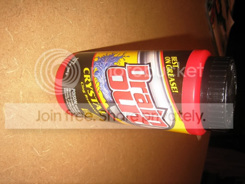

Well guys I just did this on my E-Savy parts. Here is a pict of the stuff I used.
I picked it up at Walmart for around $4.

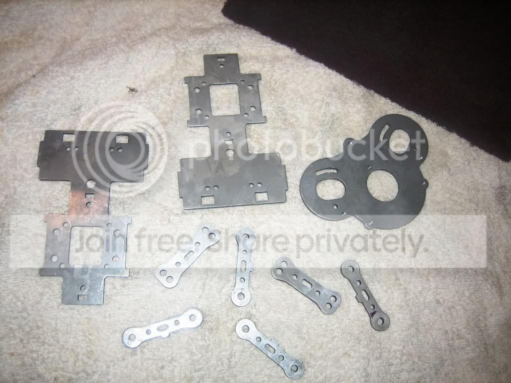

Here is what the parts looked like after about 30 seconds in about a quart or water and sprinkling a little over a table spoon of the Drain stuff over the top of the parts.
I then removed the parts by dumping them into the sink and running water over them to rinse the Drain o off them.
I dryer and as you can see in the Pict there is a scotch bright pad I will use to buff them a little bit.
This was so easy. I never thought the anodizing would come off so easy.
