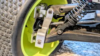

I have managed with 'CVD's' on just the front, but dogbones everywhere else. When racing hard, the front end was problematic with dogbones. Cornering hard, powering out of turns on bumpy tracks could sometimes result in a bone popping out, or jamming up.
I can't recall what these are - I think they might be HPI hardened items. 🤔
"I can't recall what these are - I think they might be HPI hardened items."
Those appear to be HPI's "Heavy Duty" dog bones (86134)
Who made those trick steering knuckles?
Nope - they're CVD's, but they're hardened and shiny silver
The brand isn't known unfortunately. I bought them second hand in 2019 - just as COVID was kicking off....
