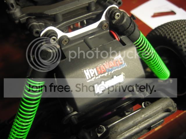

Hey guys it's been a while since iv updated my savvy build, don't worry I'm still building it, ALL FLM parts were on back order so I'm stuck with out servo mounts and i also ordered a drag link(why not only $7) so that should be here Tuesday (June 1st) so here is my custom fab rush battery box mount rockout

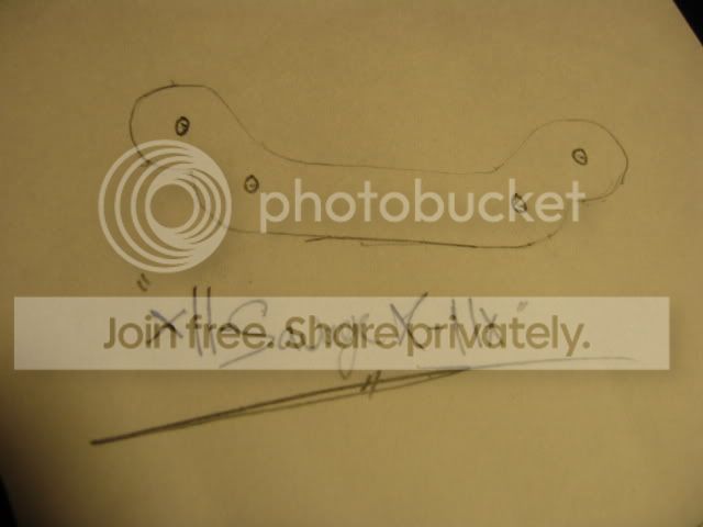

• Started with a template ::

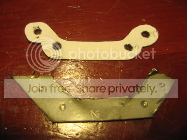

• Paper Template ::

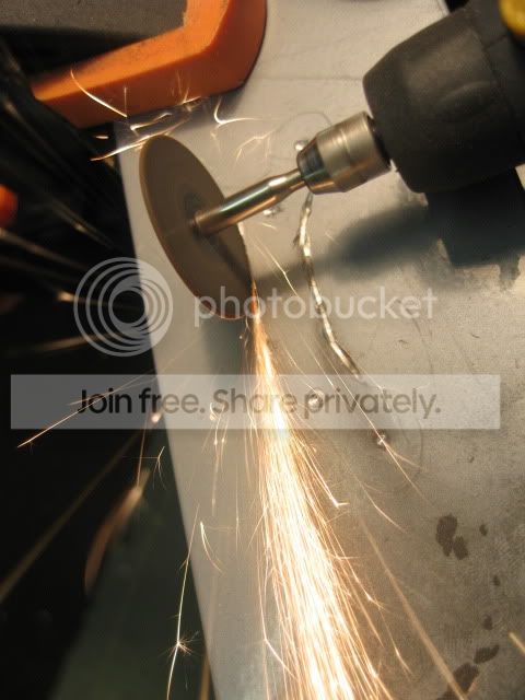

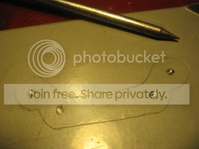

• Then Scribbed the 2mm aluminum ::
• SPARKS =D

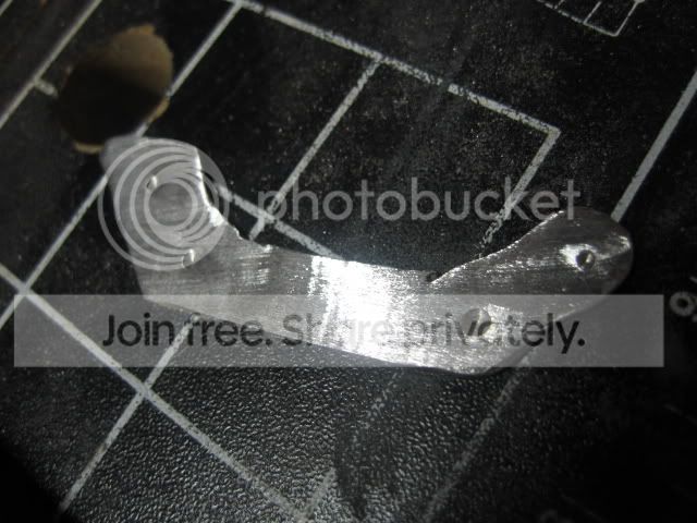

• =/ I think i worked the dremel to hard -.- (1OOF) ::
• Since you can't curve the cut off disc i took the lazy way out 😀 ::

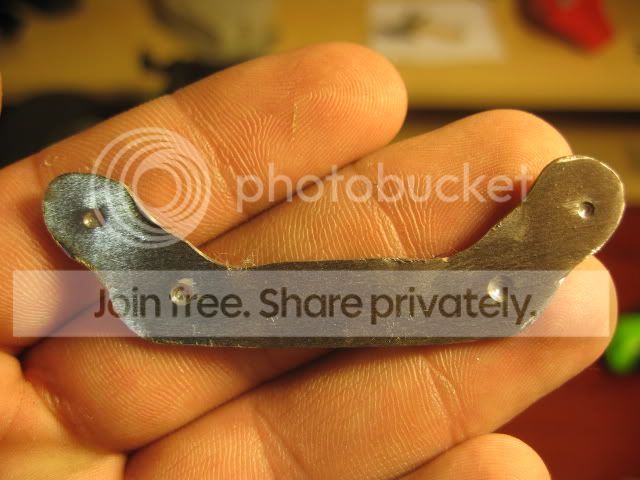

• Polished it up ::
• Fixed it up with the dremel ::

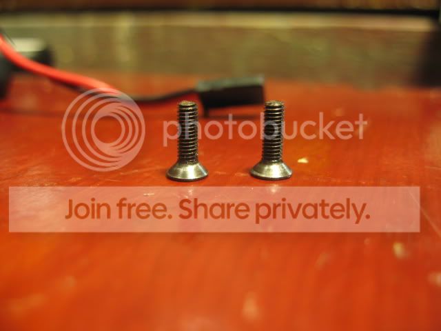

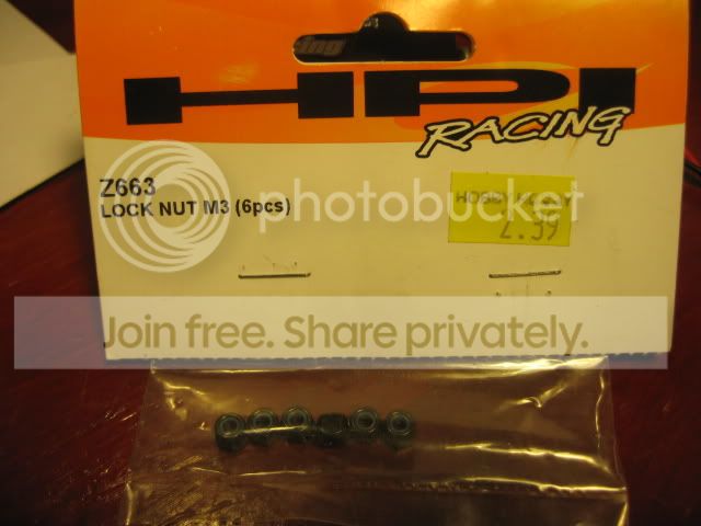

• I then found two 2.5x3mm hex screws ::
• Then i used some 3mm lock nuts ::

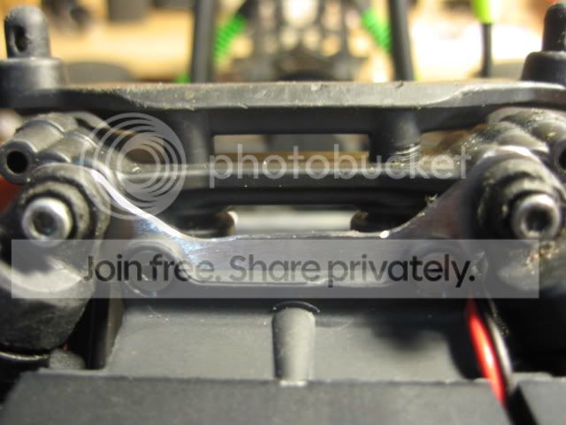

• VWALA !!!!!
• I LIKE IT =D

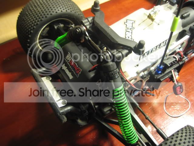

I mite re-do this because i can only use the inside hole of the shock tower and the front end sits way to low...

The shocks being on the inside hole of the tower makes the truck sit higher.... it's the springs that are making it sag. You probably knew that though... you can just extend the upper ears and put two more holes in each of them
