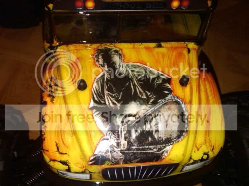

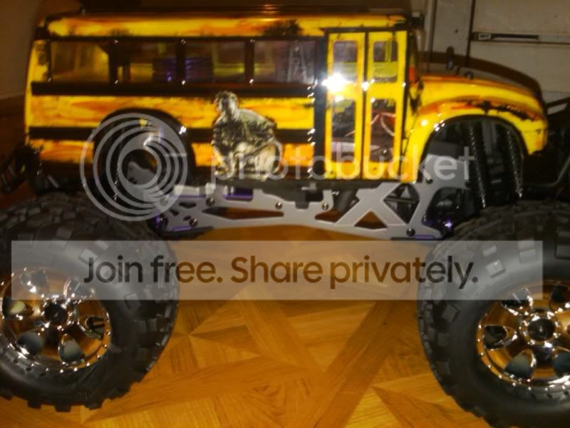

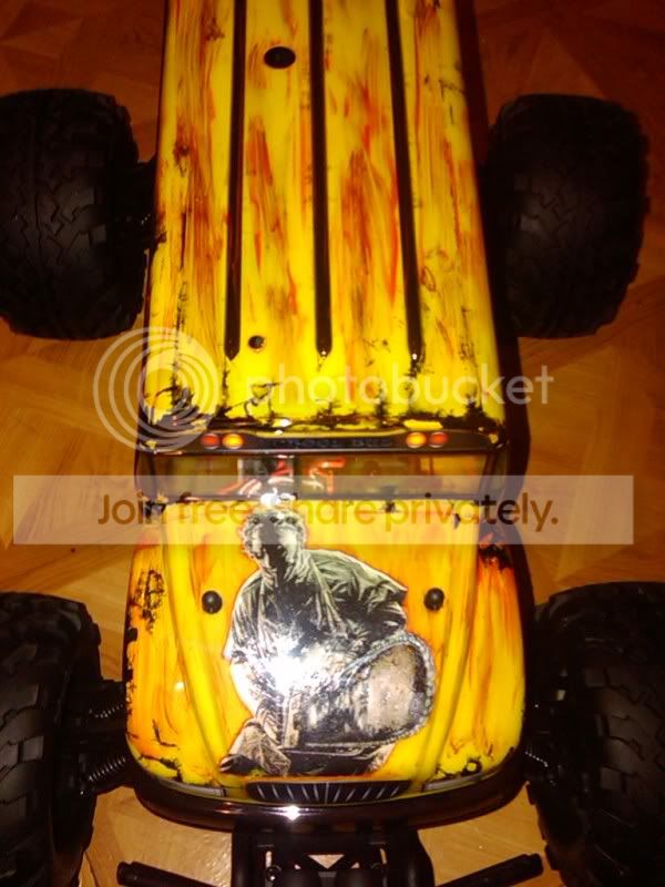

Just helping out Lyle aka maximusraylius. He just finished up last night, having computer problems and can't post them..Pics are of his phone.
Thx Scott for posting these for me. A lot of thought went into the paint scheme on this one. Might not look like it lol. But it has crazy paint effects that I wanted to try for some time now. Its hard to make things look old when they are brand new lol. ILl do a full how to and wrote up on it explaining the tricks I used to get the effects in the paint. As soon as I get my computer replaced. THX again for the help posting these Scott and thx everyone for looking. Tc be safe bash on.

Thx. I think ill call it the smear tecnique lol. I air brushed each color on and while it was wet I smeard it with my fingers to get the effect. The only one I didn't smear was the black. That's a wrinkled up tape effect so it bleeds under in random paterns only think that was actually masked were the windows and trim. Black was done first to keep the other colors bright.
Thx triple S. Took me about 5 hours. From start to finish. Counting cutting the lid out and slinging the paint on it and masking it and using blow dryer between colors. Finished it up around 2. In the morning. Once I started I had to get it done cause each effect was coming out like I wanted. So had to see it finished.
