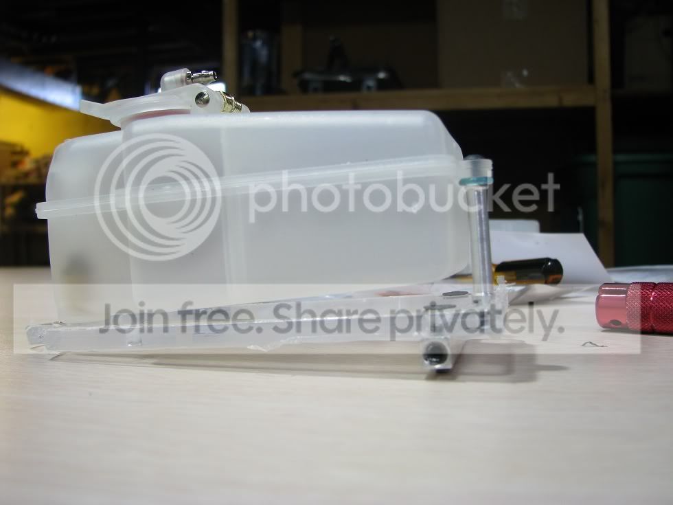

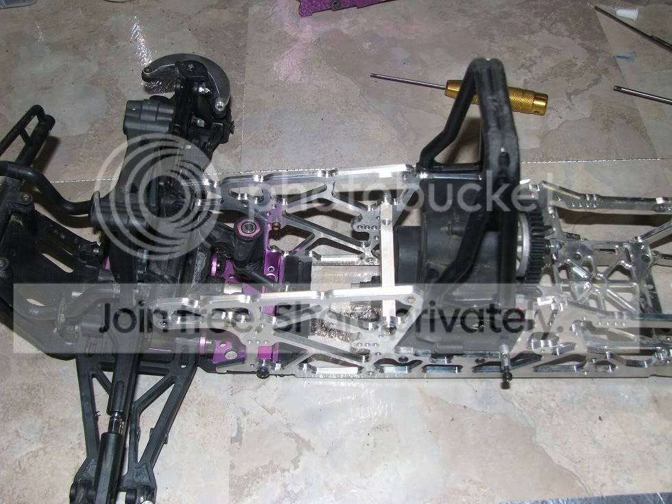

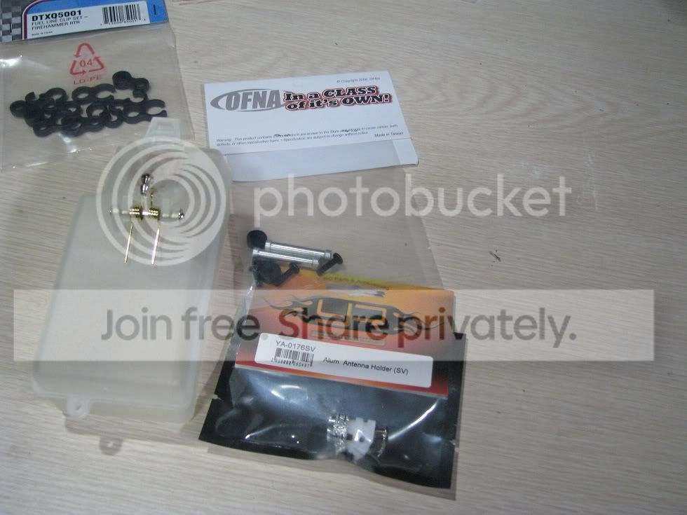

I got my plate another tank and posts from robert last week ,I haven't had time yet to play with it anymore but I had test fitted the IRC plate to location it will be installed , everything lines up , with minor adjustments to the rear of the plate I can mount the rear lower brace , the front brace will need one hole tapped , as far as I can tell the front of the plate only has one mounting hole.
can anyone with the irc plate confirm this ?
I hope to have some time this week to install the plate , run the wires ect .
in the next month I'm going to have a whole house full of r/c cars/trucks(9 in total now) and need to clear of my bench and find room for them all.
I will post updates and pictures when I get closer to the end of this project.Jay and Bob

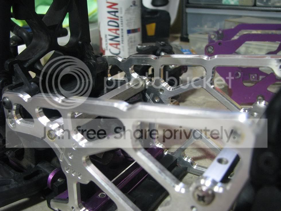

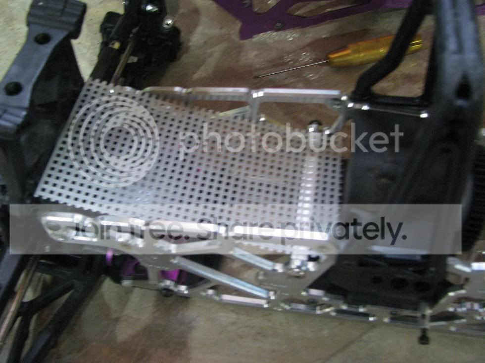

bit up an update , I had a chance to work on the truck tonight , so I'll do my update now , before I head to bed , sleep for 5 hours and go stain a deck .
I"ll start with the steering arm I fabed up tonight
I used two endlinks and a rustler tierod , that I had spare of .
I cut down the tierod and added the endlinks

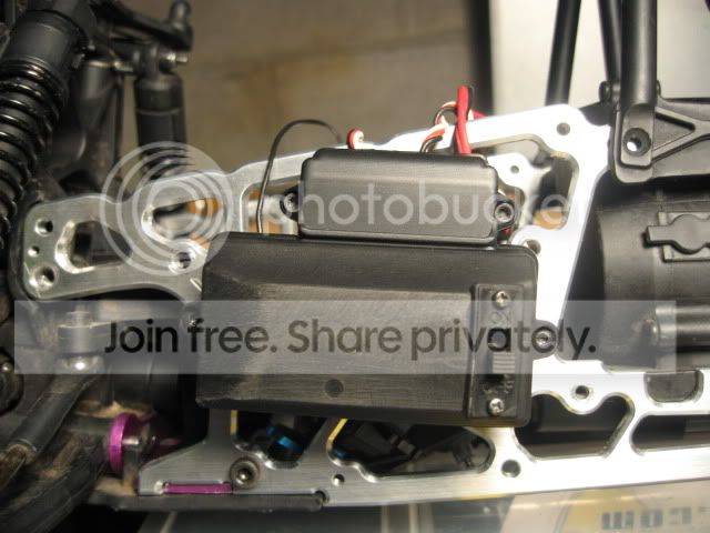

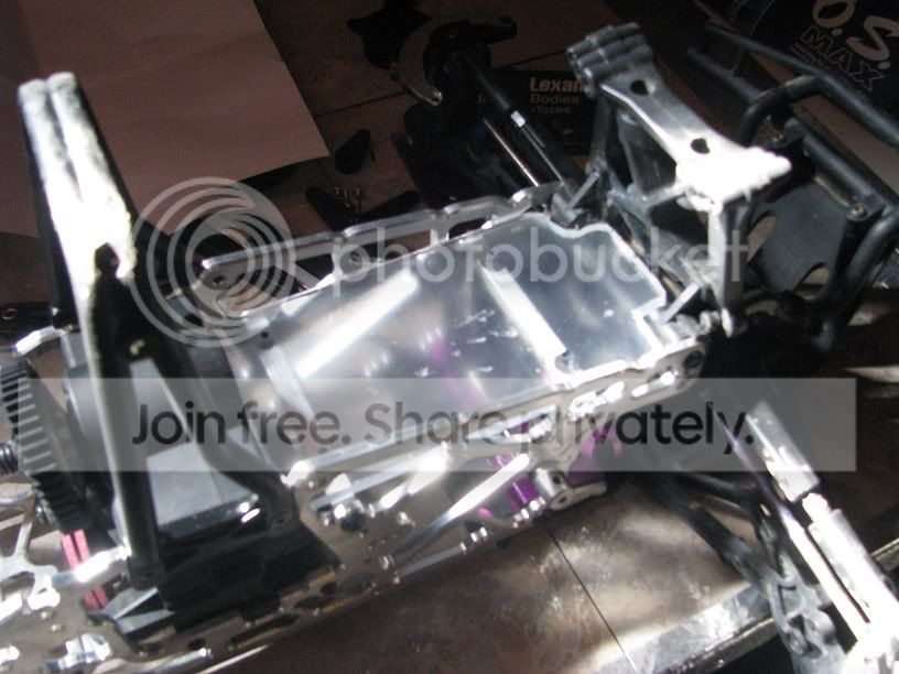

next is the radio box , I fabed this up using a rush box , cut it to fit filled the holes and ran my wires in the box , mounted up the mount ,

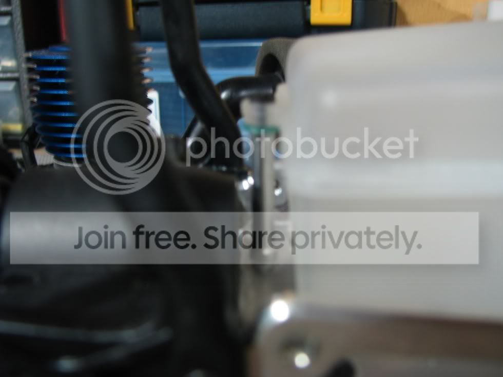

I used the two posts that came with my IRC plate as they were the right height I needed , since these were extra I didn't need to order any others ,as I was just going to order some axial ones.
I have lots of clearance above the drive shaft wires all clear and such .
I ran my wires from the front servo to the radio box , I slide then inside braided loom left over from another project , I think it makes it very clean , and less likely of heat or other items coming in contact with the wires.
I didn't really want to mount the battery to the rear shock tower but I have to work with the funds I have , so for now it will have to do ,
I would like to put it rush box and have it mounted to the front , run the wires back with the servo wire.
I also would like to get a long horn for the steering.
but for now all I have left to do is linkage I think ......

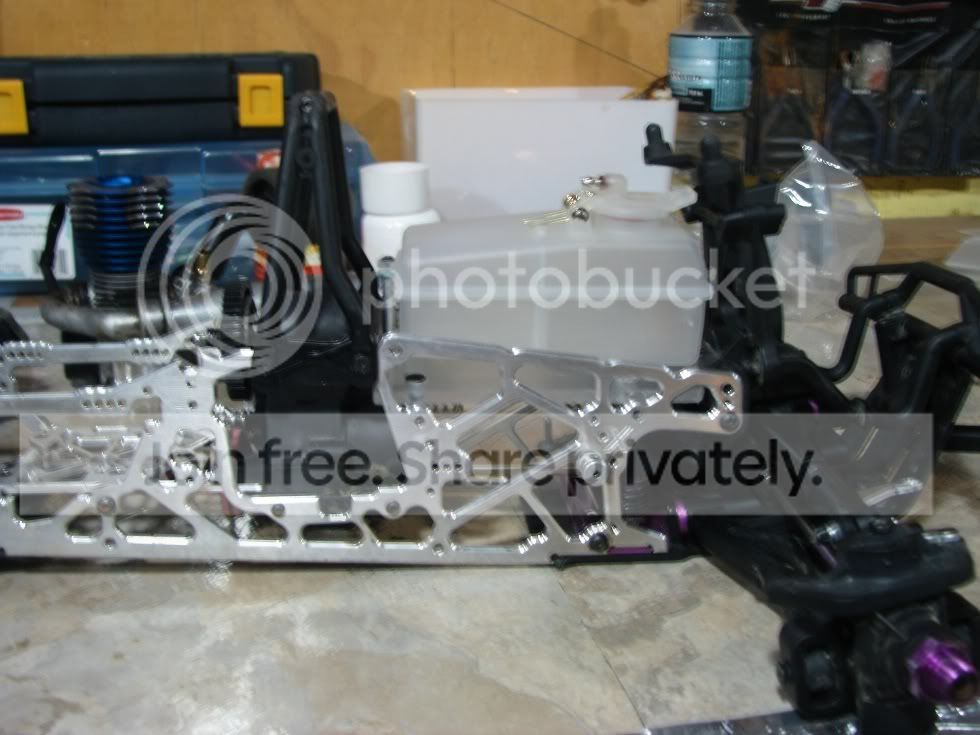

another quick update ,
since i's all finished now I broke in my os.30 ,
the truck just screams down the track , We have a BMX track right next to the R/C track , the guys repairing the track took the time too stand by and watch as it flew down the track .
not only does it look slick but and boogie too .

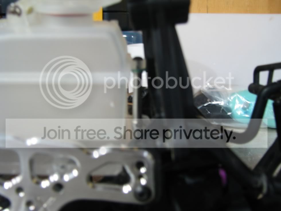

the truck now seems to be more front heavy compared to a stock X . when I take a jump the front end want to drop right away .
so I'm thinking of maybe tweaking the front springs ?
so I maybe have to practice more on the throttle more , then I did with a Stock, as a stock would have more rear weight anyways .
but so far , I'm loving the Mid tank , and I notice the lean problem more now in my other truck.

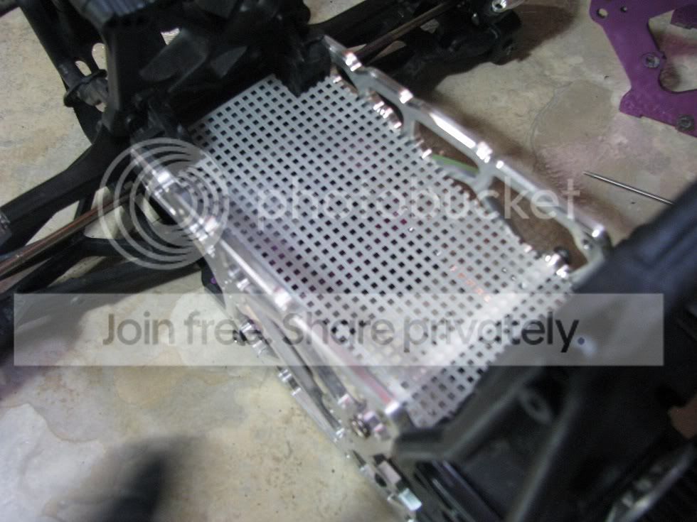

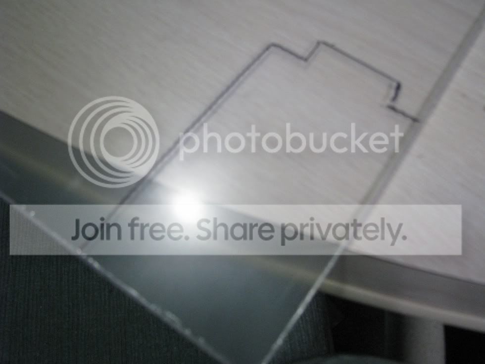

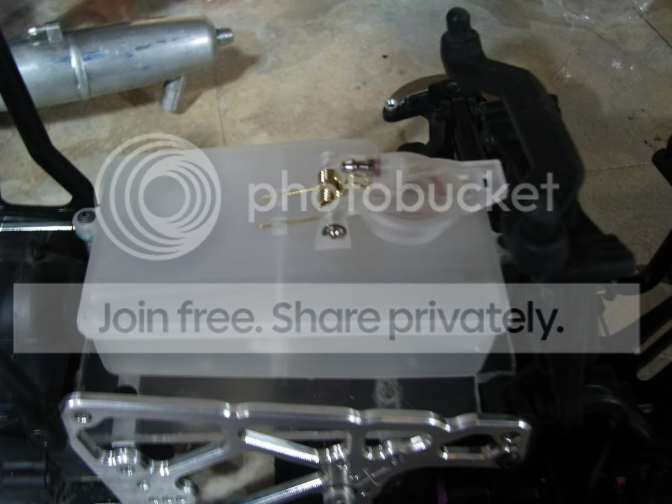

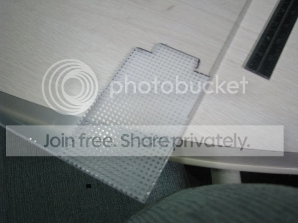

from what I have read you can still do the 250 tank , since your making your own plate then you can fit it and move your mounts as needed.
use cardboard or paper or something to make your template ,
you won't be able to go in to the bulk head like the X can ,
I would have to check my s25 bulks to make sure , but I remember hearing something awhile back about this .
other then that you shouldn't have a problem , pick up some linkage rods , ends , the mounts . you should be good .
you can buy a longer steering link or make your own if you have alot of spares like I have .
I also added a longer servo horn on the steering .
once you start to mount it all up you can see where things should go and it come together nice.

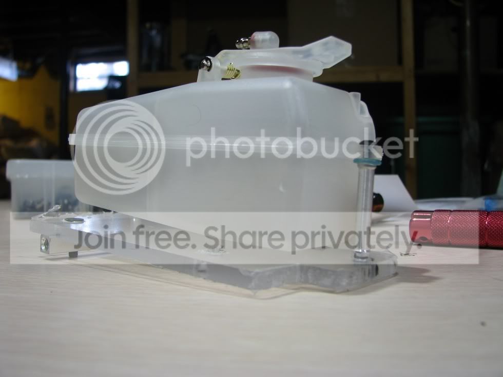

if fuel size doesn't matter to you that much , then I would do a smaller tank and add the receiver box up front with the tank as well .
it saves you from getting a mount and battery box ,
Which I haven't done yet my self but need to as zip ties aren't working all that well.

for the front IRC plate mount , I used an old TVP brace I had a motor plate from a S25 is the same but the X has the hump in it which won't be as strong.

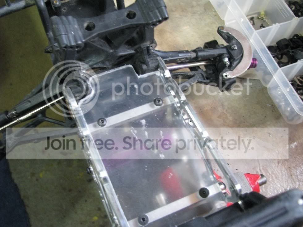

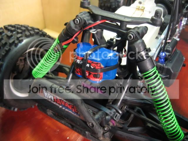

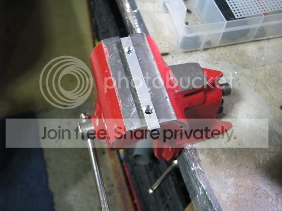

Update here ,
I made my battery mount and Wing mount today .
Had old parts left over from an LSt2 that someone gave me .
I managed to use the front tower with very minor trimming or adjustments for the battery mount .
I then used the rear mount again with very little adjustments for the wing mount .
I'll grab some pictures in a few
heres the pictures of the battery mount I made up ,
using old left over parts cost me nothing.
I forgot to take pictures of the wing I'll grab those later.
pictures are big , photobucket never likes to resize for me .
But as you can see very little mods done to the front tower to fit .
I trimming and drilled the three holes for mounting it to the tower and the shocks.
battery mounts to the lower part , i am still able to open the box and change out battery if needed with out taking it all down.
later I'll post the pictures of the wing mount .

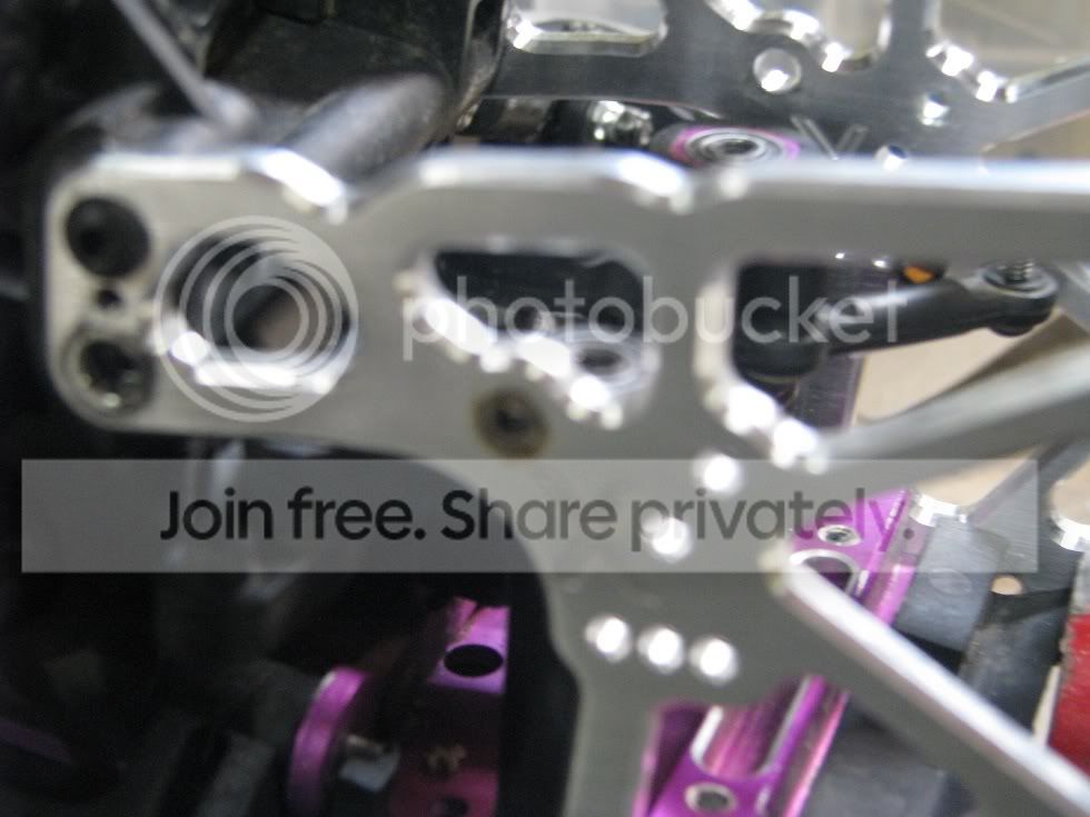

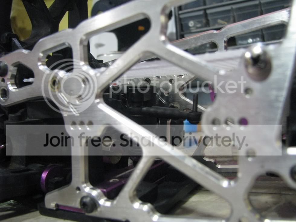

Looking good chimera. I am having to go the same direction you habve gone as the irc servo would fit (made the sevo sit to high so then the arm hit the plate. I have go a couple of questions for you.
1. Did you use the innovative rc rear brace (one with the arc in the bottom of it) if so did you have to drill and tapp any holes into the side of it?
2. I see you have drilled and tapped a hole in the cntre of the front brace? Is it purpose to hole the plate down?
3. does your plate sit flat?
Sorry for all these questions littering your thread lol. Your build thread is reallly good and has lots of advice.

No worries , here to help .
1 .No I did not , I used a standard alloy tvp brace , hmm might be FLM .
didn't have to drill any sides holes , they were already there.
2.while I am not using the IRC TVP'S and I improvised .
when I mounted the tank plate , it rested over the steering links with two larger holes for the two bolts to go in too.
which still allowed the tank plate to move up and down .
I added the extra screw just for my peace of mine.
buying the midtank kit might have resulted in different results .
3 my tank plate sit flat yes , and I'm never worried it will bust off or move in a crash or flip over.
any more questions just ask away .
