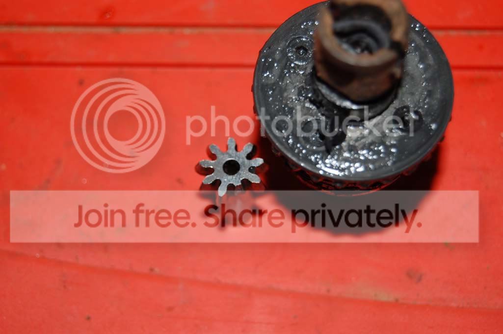

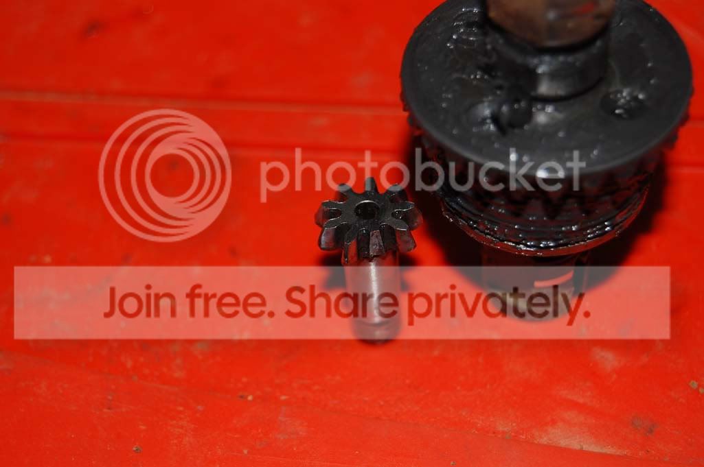

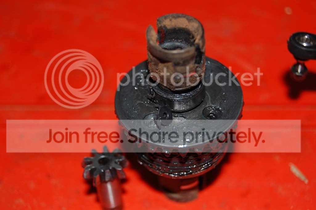

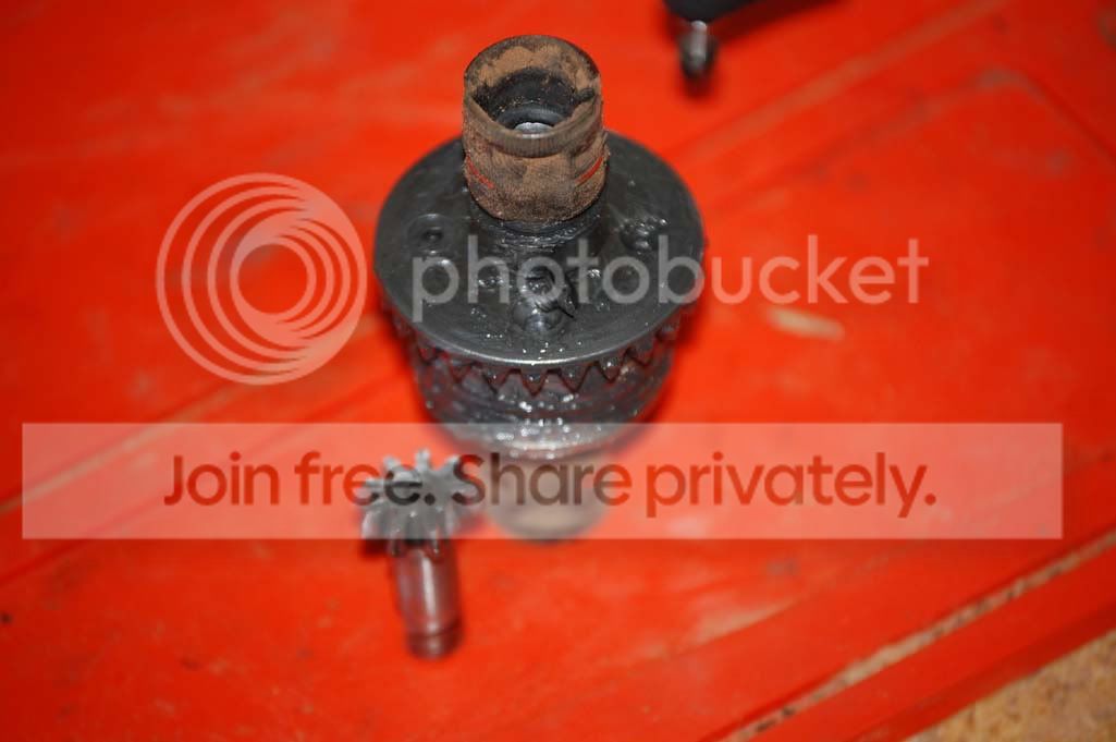

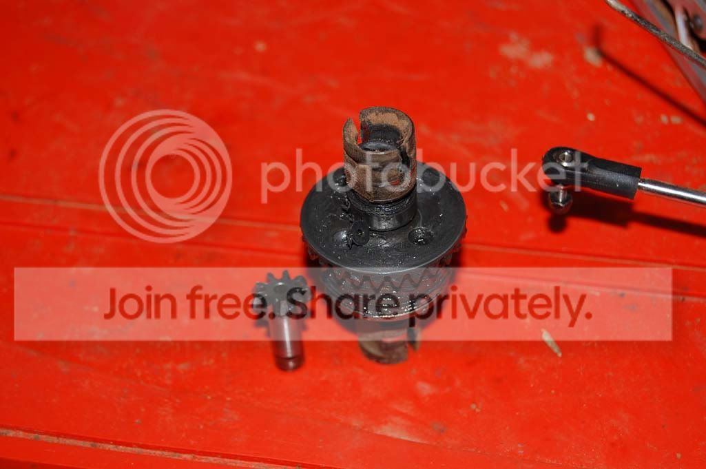

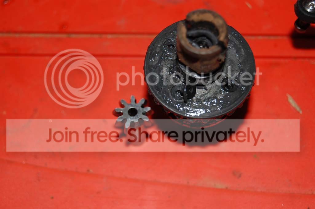

Was working on the Savage and found my rear cen diff was tore up..

Sunk, when you built the diffs, did you remember to lock-tite the screws? I know it's a dumb question, but just curious. The damage was more than likely caused by the screw that broke and the other that came out. With the Cen diffs or any other part that has 4 3mm screws holding it together, when 2 of them come loose, kiss the part good-bye. Same thing happened to my buddy, only it was one screw that came out and wrecked his diff. Also happened to the clutch holder for the 2nd. gear clutch. Just my 2 cents on the matter.

The internal gears, the ring and pinion are indestructable, for the most part. But, like I said in my other post, if the screws break or come loose, it all over. Also, the cen outdrives that come in the cen diffs are crap. Break way to easy.
Yeah looks like the screws gave way and screwd up the mesh

well the pinnion is from the rear the diff the with the busted screws is from the front of the truck...
so who knows
