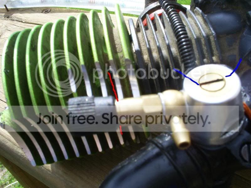

ok on the axial 28 the factory settings are flush on the mid range needle the high side needle should be flush with grove here is a pic to explain the high side needle grove the red lines in this pic shows u the grove that the bottom of the high side needle should be flush with it and the blue lines are showing u mid range needle should be flush and the low side needle should be flush
to: ljrce
OMG, thank you so much! You made my life easier now. That is very interesting instead of remember how many turns and stuff like that.
