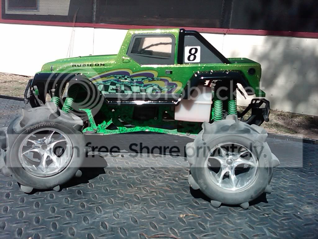

heres the ones i use ... pretty much only wheel ill buy any more ... 14mm hexs never failed me even with the paddles on assphault...
Thanks Max...that X is sicker than the 3rd floor of the hospital. I'm goin with what he's gonna have for me. At worst ill still have my stockers for backups if something happens. I'm learning its best to have 2 of everything anyway.
thx .. thats just one my twins i run at the sand dunes,,,, as long as you keep the wheel nuts tight they will hold up .the back side of the wheel is nice . its reinforced near the centers .. like i said i ran my sets for over a year beating on them on assphault as welll as dunes never striped a hex ever on the 14mm. even with my lrp engines .. have a set on my xl as well.. youll like them ... ohhhh they dnt have air holes ... so drilll holes behind them before mounting the tires so they can breath,,,

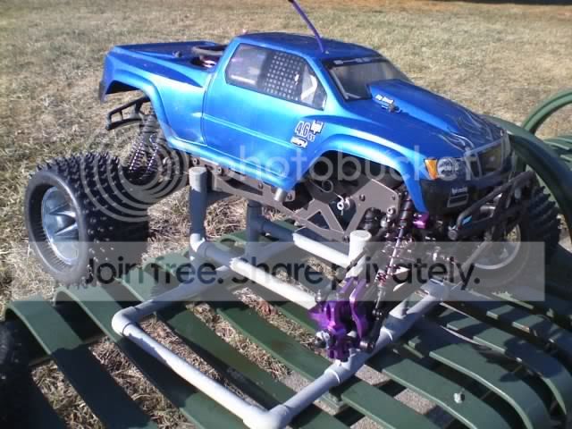

This was my first savage ... BTW they suck ! (sorry max)

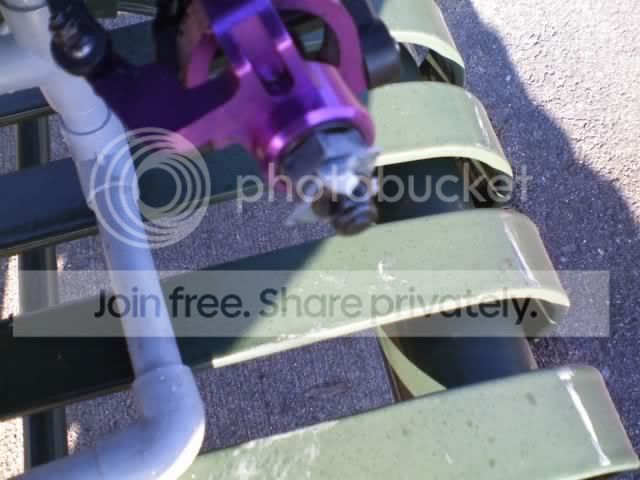

Don't worry about stripping the hex ... it will rip out b4 that will happen. (Stripping occurs when the nut gets loose not from power, Just FYI)

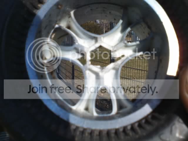

This is me unmouting the trash ... they broke running over a one inch in diameter stick at WOT RPM arms and RX boxes are good. Rims suck ... Also they would not warranty it! So the " lifetime" is very limited ... Stay away form this rim on a savage. A lighter truck my work well ...

If you look close you can see the stick I hit in this pic... its also 50F degrees that day don't let the left over snow fool you that they were brittle from cold

I honestly just ran over that stick Max. it was way above freezing thats just left over snow pack down from a good 24 inches. you can see the mud and grass in the rim the ground was a sponge... Venting the rubber is better for any tire then the rim anyways. A leather punch works best 4 holes at 12 3 6 and 9 o'clock helps expel water and other issues as well. But some guys fear it ... Trust me they don't hurt it.
