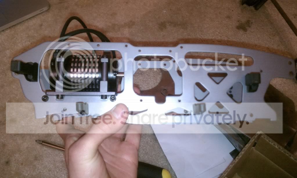

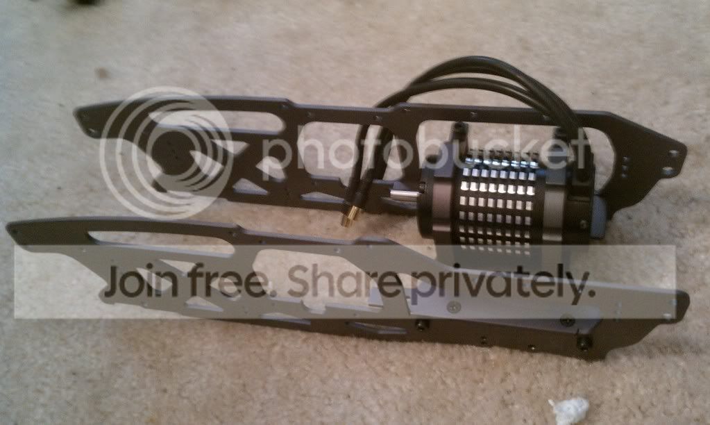

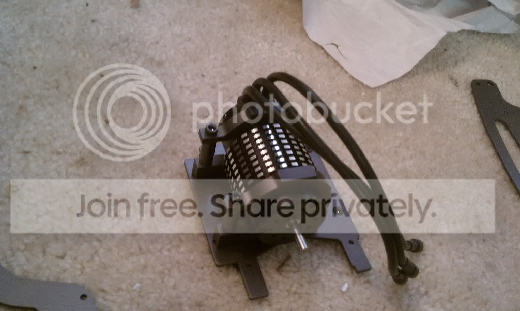

alright heres the flux update.
went with stock tvps. they were only 2 dollars so couldnt beat that.

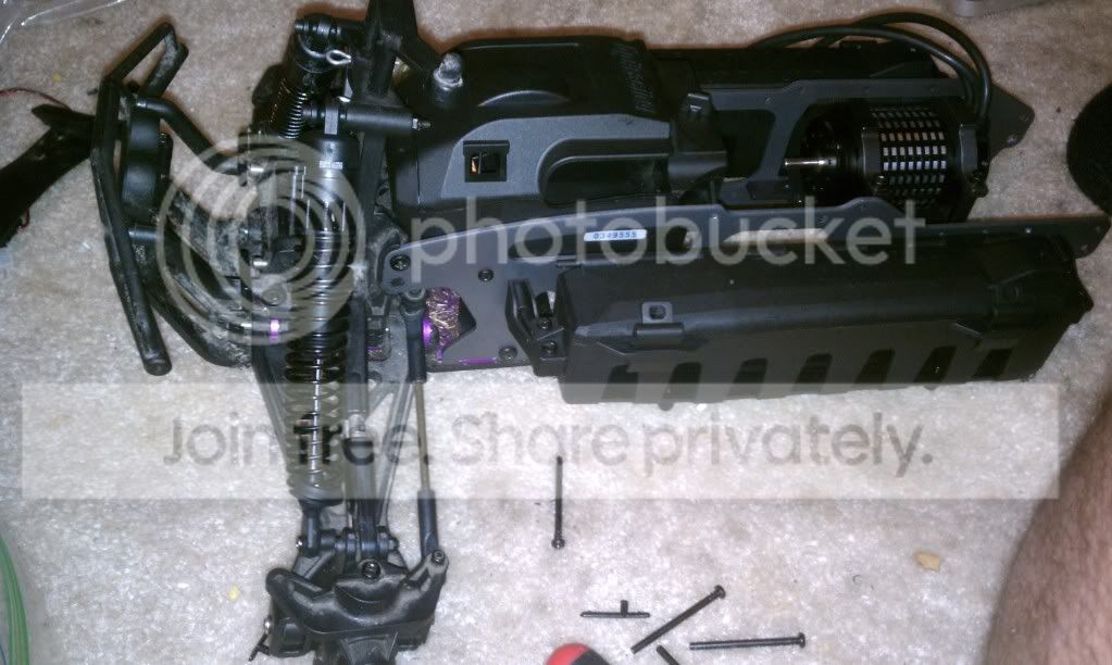

now on this next pic can anyone give me a part number for the screw that goes into the radio box? on the 25 radio box that screw isnt required so i don't have em.

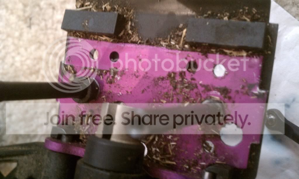

on the left side i was trying to put one of the screws into the tvps and it would spin and never get snug like the rest. took plates off and this plate
doesnt sit all the way down. how does that plate come off? figuring theres some dirt or somin under there keeping it from going all the way down.
Take all the screws off for the skid plate and the lower bulk plate will come off. Then clean it off! Lol pretty dirty for a new build lol. Do you have the plastic tvp braces? May be time to apgrade to aluminum, or else you can get a longer bolt and run it through the brace and put a nut on the end.
