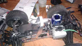

Its seems good so far but when the tank gets half way down it seem to act up a bit. May have to look into that. Mabe put different style tank on it. We got almost five tanks through it and the darn throttle servo crapped out. My poor boy cant win for loosing on this truck.lol will be a bit befor i get into the hobby shop. Closest one is about an hour.
Oh ya its the .30 modle

You can always manually open the servo and prop the wheels off the ground and have the truck go thru some gas that way. set it on blocks or a 12 pak works good too. just put down a rag becuz it will let out oil from it running. open the servo enf to get the wheels turning.
I have the same engine on my X. I could not get it to run worth a crap with the stock tank, no matter what I tried. I tried raising the tank, removing my primer bulb, lengthening the line, tuning when half empty... it just ran bad no matter what.
I threw on a 125cc buggy tank and it ran great.
