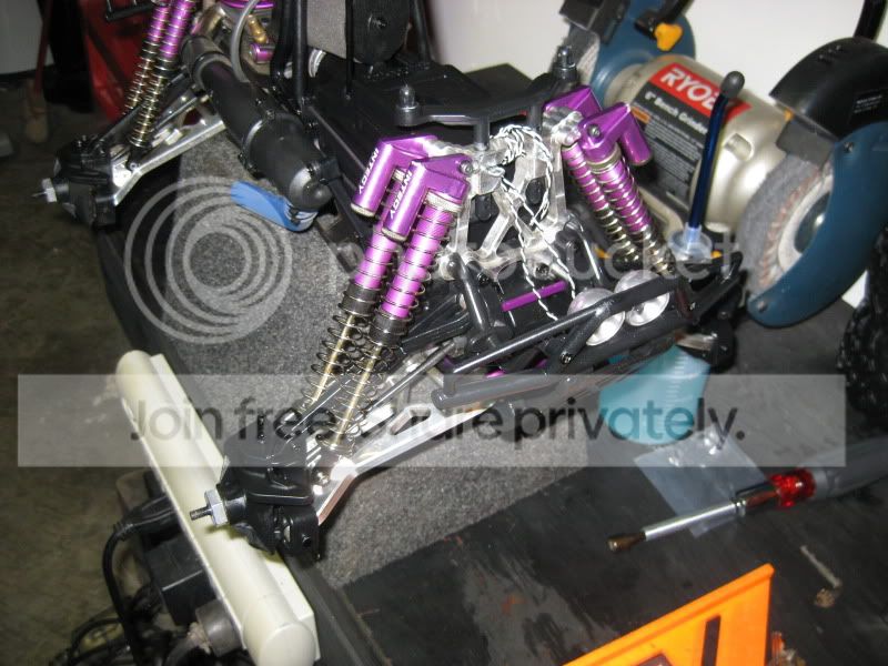

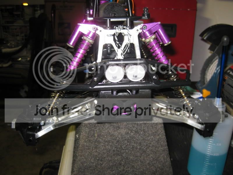

I have just finished my second tank of the break in proceedure. I haven't gotten above 1/2 throttle, but I am noticing some issues with the suspension that I will have to address. I was hoping that you guys could give some advise. I will post pics of the current set up and you can help me go from there.
What I am experiencing is a big tendancy to wheelie...lol...seems the front end is realy light, and the new era wheelie bars do little to help the issue, to me it seems more like a skid plate as it is tucked in so tight to the factory bumper...it rarely seems to stop a wheelie, but the truck is new to me so it could be just that I'm not used to the power yet. I would like to give the front end alot more traction. Granted I should tell you that I was driving on a mix of grass and concrete, but the suspension issues seemed the same on both surfaces.
The other problem is that durring a hard turn I am experiencing a complete lift of one of the rear inside wheels and the wheels seem to be going almost to the sidewalls of the tires durring most any turn at even low speeds.
Thother than the suspension issues the truck is running great, I love it so far and haven't even gotten to shift into second yet. I have rolled it 2-3 times, so like I thought I will be adding a complete crash cage soon. I am wondering if sway bars will help with some of the problems that I am experiencing or if I should play with the set up of the supension first?
I am curious if the front and rear of the truck should be set up differently to compensate for the different weight front to back. Is it like the suspension set up of a real car, do you guys ever wheigh the individual wheels to see how the weight is distributed? I am considering lowwering it some to help with traction, but I kinda like the current height. Pics of current set up:

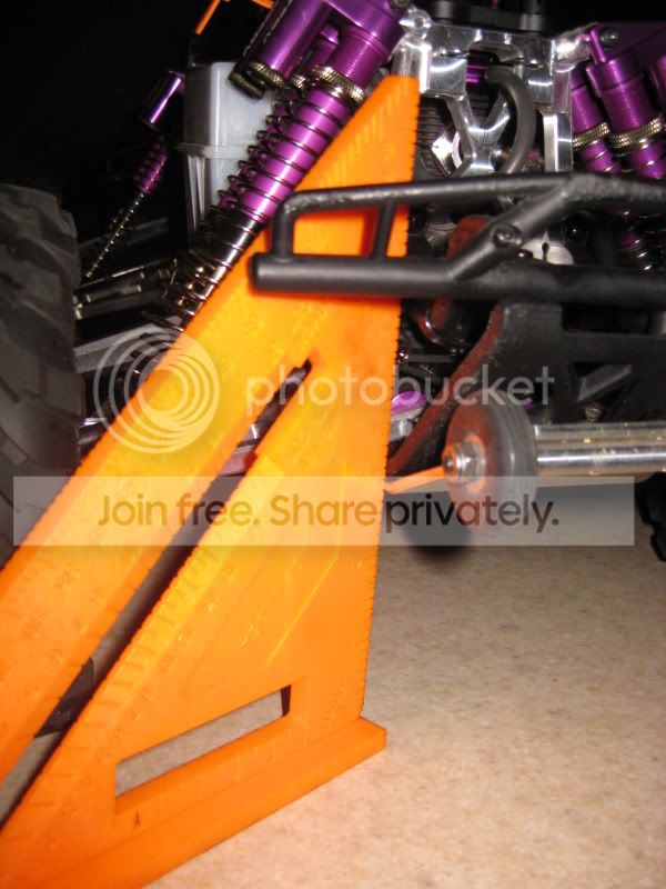

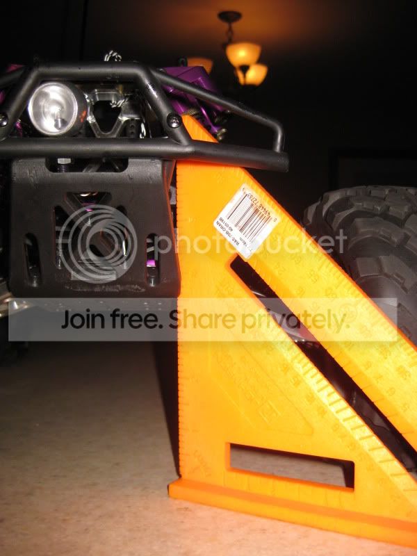

Ok...I took some static measurements and it is quite possible that the addition of the new Integy shocks and New Era lowwer arms may have changed the suspension set up a bit from stock.
My front end measurement was 3 7/8", while the rear was sagging at 2 7/8". That is a 1" bias to the rear, which would explain the lack of front end traction and constant wheelies with all the rear taking the majority of the weight.
I have since readujsted the suspension and have the set up at 2 1/2" at the front and 3" at the rear...time will tell if I am heading in the right direction.
Here is the measurements prior to adjustment:

No I left the 50wheight Losi oil that came free with the shocks from my local hobby shop...I did remove all of the adjustment out of the front springs and left the rears at half way...here are some pics taken after the last run
I also moved the top of the shocks all the way outbound, which gave me a decent amount of drop that added up to a better suspension set up.
