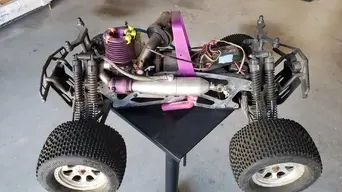

is it ok if I use bones brew 30% nitro 10% oil on my Savage 25 engine that was sitting for like 10 yrs of doing nothing? It's the only fuel I got and I got 6 quarts of it..
It will work, just keep in mind it is just 10% oil, so lube and heat may play a factor, keep it rich and run it easy till you know how it does...
