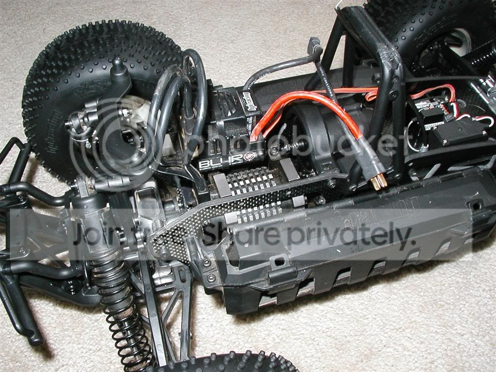

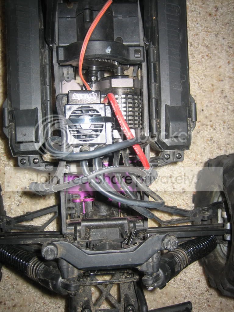

Hope this will help.
The easiest way to find the right wiring is to set the ESC and motor down so the ends with the connectors and wires are towards each other, then just connect each one to the one next to it...
For the Deans:
__=red
| =black
The top of the "T" on the first one goes to red, the other piece goes to a black wire to the top of the other "T", and the bottom of that one goes to the ESC black.
