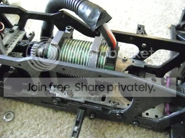

i sold the MMM motor 🙁
but there is a good reason to this, the motor mounts i had striped out so i have to order a new set, with me doing this i do not feel like moding the new mounts to work with the castle MMM like i did with the last set soooo I'm going to buy the flux TORK version of the MMM 🙂

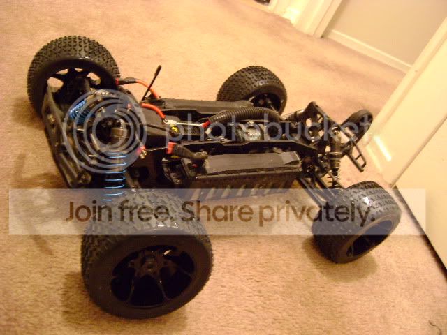

body shots!

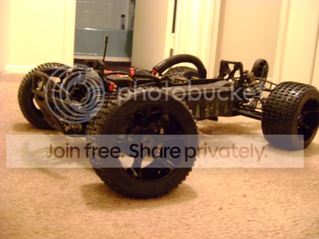

new pics for a "newly" born truck
hmm you look familular black lol and baddasz savage your savy looks awsome........

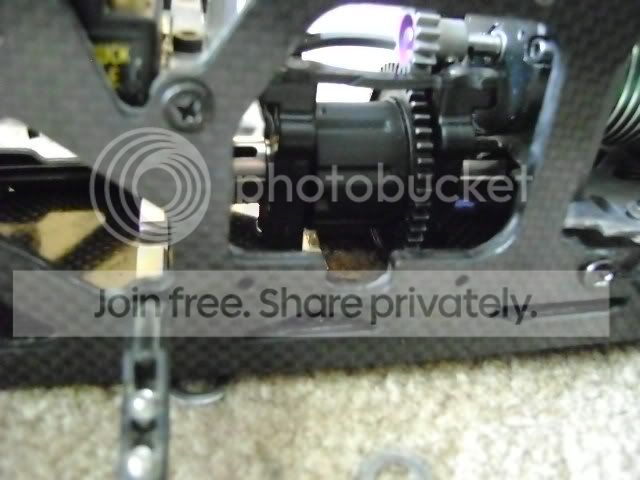

also, finally did the deed and opened up the diffs and put the real truggy outdrives in since because in the rear i couldn't set the camber right as the cups were not right.. all is good now i also filled the front diff with 20k and the rear has 7k, i believe i filled the center with 7k aswel.
another thing i decided I'm going to TRY is the plastic center diff gear from the 8T. I'm doing this for a few reason, the plastic spur is much smoother, along with quieter... i hate the noise the flux makes with the metal to metal so this should solve that. also its much cheaper to replace a $8 plastic gear compared to a $12-15 pinion gear. also cheaper to change out a $8 spur if i want to up a tooth or go down a tooth.

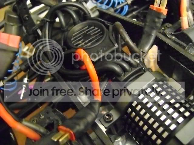

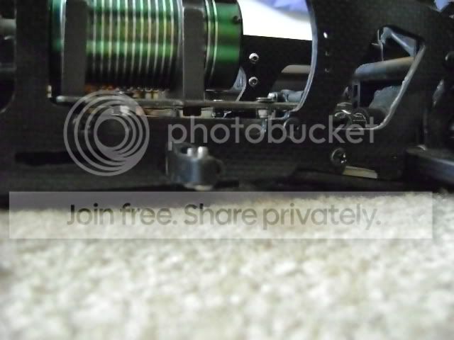

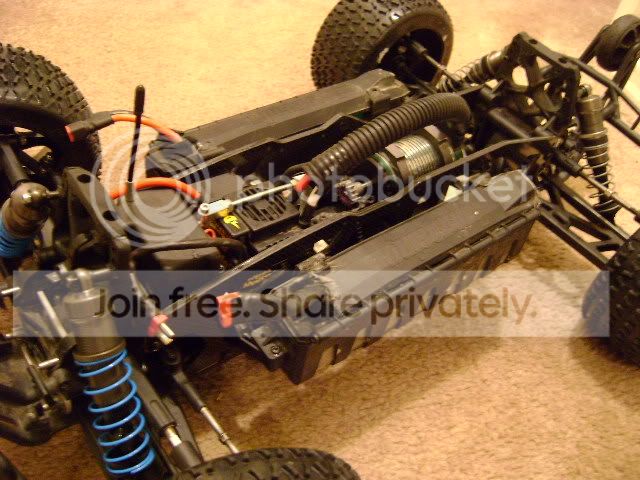

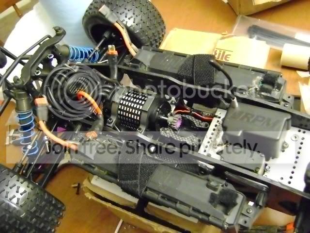

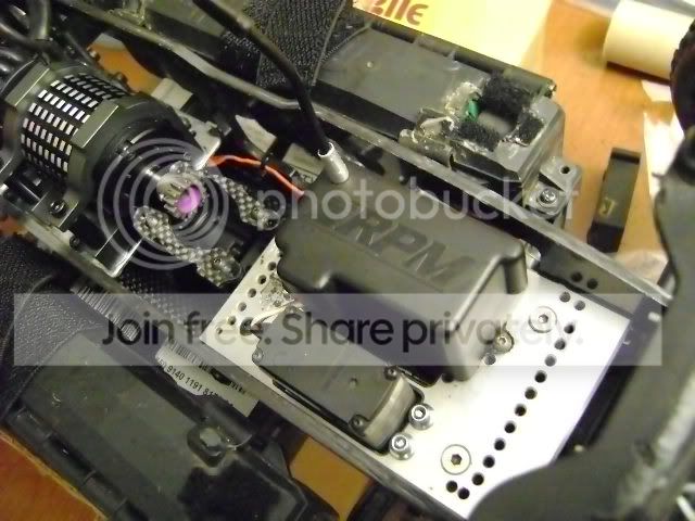

well i ended up makeing a few changes... major one was a esc relocation. i fabed up my own mount from behind the motor out of plexi glass and used the traxxas esc hold down.
what ya think?
