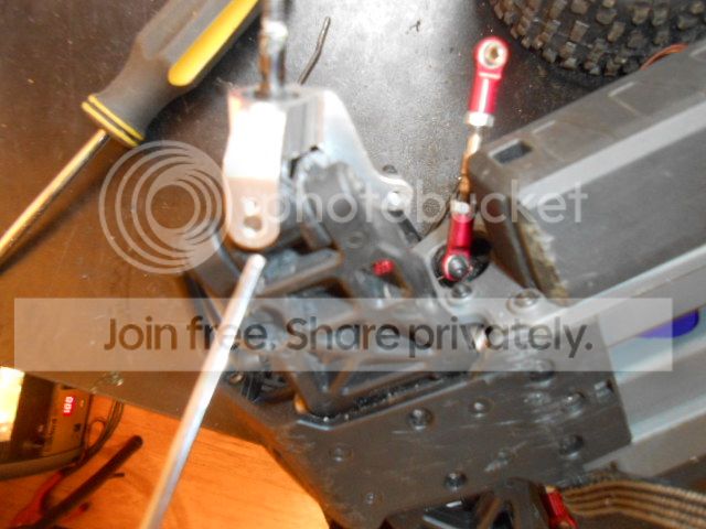

can anyone give me a pointers on how to remove the pins for the uprights on this thing w/o breaking them !!
I don't think I've ever had to remove them. All I can think of is to tap on the knuckle til it slides out enough to grab it with a pair of pliers.
Go to a dollar store and get a dentist pick, it'll reach under to push the pin up, then you can pull it out. There should be a tiny hole just above the axle cup.
