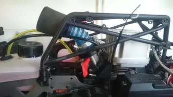

Btw, in this photo you can see the lid of the tank being a a normal bottle cap, simply because the original tank cap leakes gas when I turn the car upside down. It leaks through the air vent hole, is that normal? I thought there would be some kind of check valve inside to prevent leakage.
Mine leaks a bit. I would classify it more as a seep. It has covered the cylinder head at the bottom.. I say it is preventing premature corrosion!:woot:
I would be careful with gas covering the cylinder head. Gas is highly flammable ... :nailbite: 😉
That's my biggest worry in such a leak, the car flips over 100m away from me, gas leaks out and onto the hot cylinder head, and we have an american action movie IRL 😉
I took my cap apart and cleaned it, now it is perfectly tight again. Recommended solution 😉
