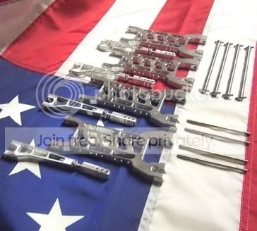

some of these but they are a little pricey
heres a link:
http://www.fastlanemachine.com/PublicPortal/NitroProducts/Savage/tabid/56/Default.aspx
