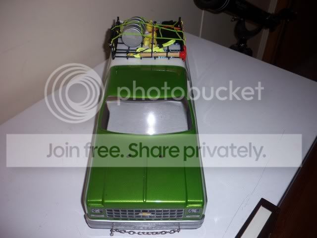

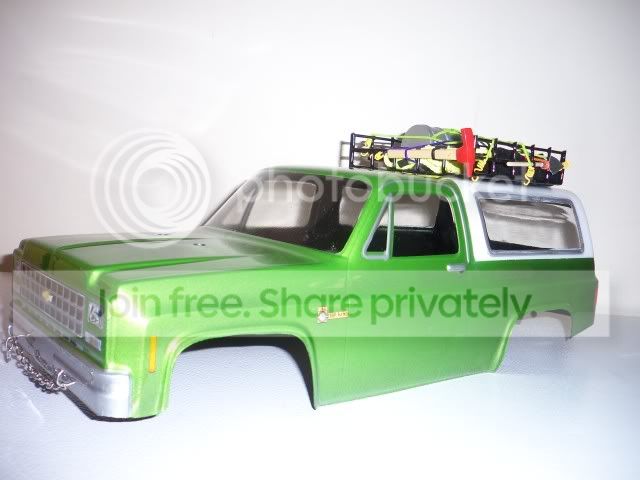

i painted this saturday for a freind its not for a savage but i think i will do one for my savage or maybe the ramcharger
looks great ! if you want a real nice glossy finish on those, clear coat your basecoat paint, let harden a few days , water sand 1200 or 2000 and buff it . you d get an amazing realistic gloss.
Test on scrap to get the right clearcoat depending on what paint you re using, basically any good PU (Polyurethane) or Polyester clean coat will do, PU being my fav but it s all a matter of taste !
It will also protect your paint job from light scratches and dings efficiently !
Sweet! I love the K5 and ramcharger bodies ( I have a 1:1 ramcharger so that is a plus!)
Take it this is going on a crawler?
Looks good!
