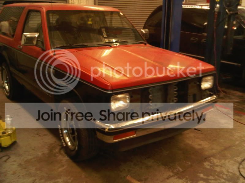

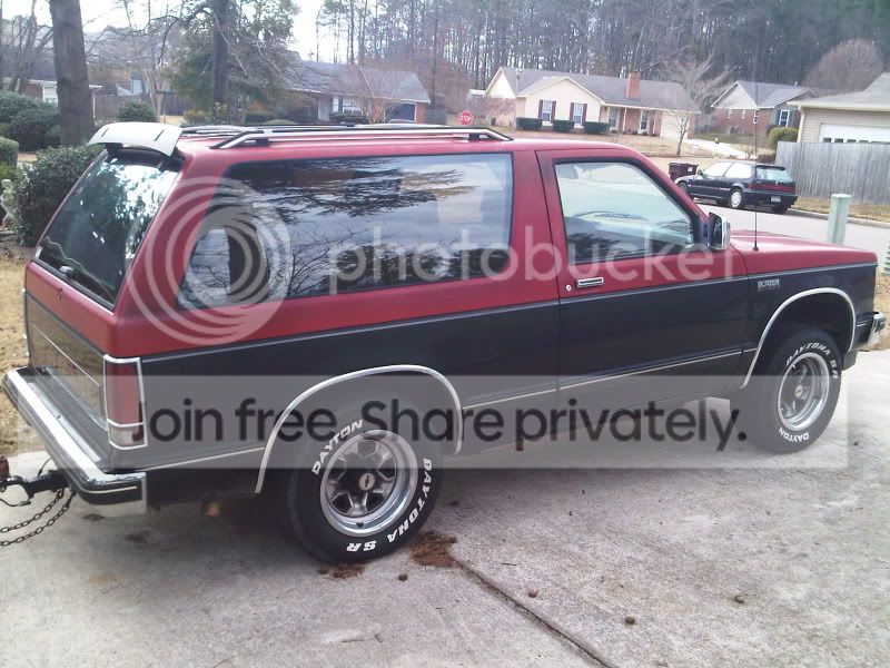

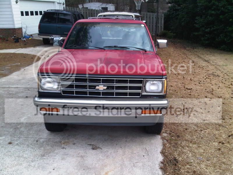

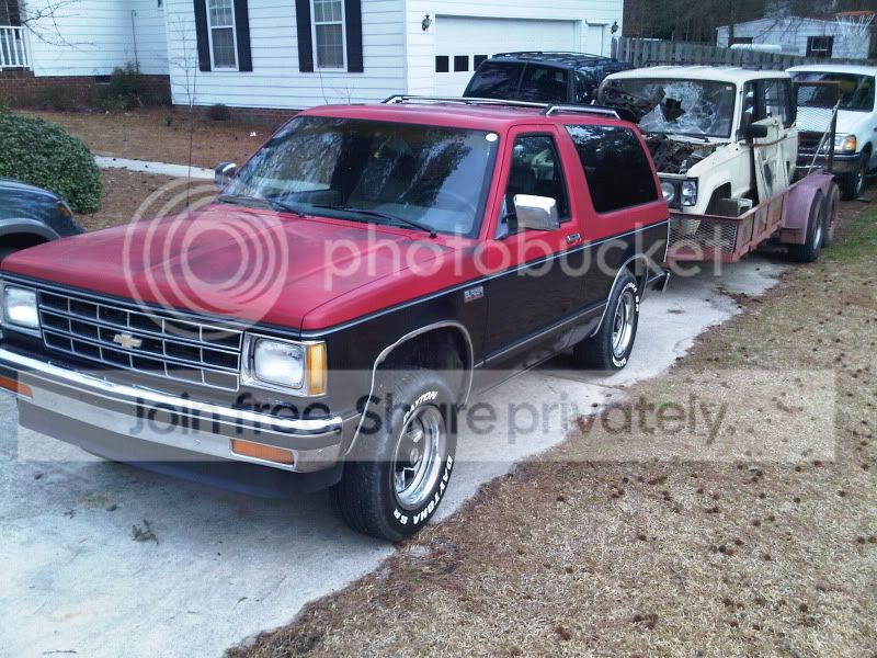

Ok so as most know I take automotive at school. Well we have a 1988 S10 blazer, bought it new in 1988. Anyways we have used it to tow trailers and such for lawn care and it has gotten its dents, and paint is fading. Decided to get it painted. Well I am painting it in school...so it's gonna be crap most likely but we shall see. Going to start prepping it Friday or next week. Waiting on materials.
Gotta decide on a color though. Go back with red/black...or here is some thoughts. Here is some pics of it now.

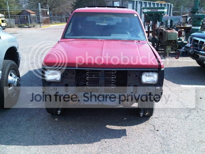

Got it into the shop today which is where it will be staying for quite some time.
Got the chrome trim off, grille, headlight trim, roof racks, and started taking the front/rear bumper off. Hope to get the front bumper off and the front left fender off tomorrow. Will keep this updated with pics as it progresses.
are you looking to keep the chrome bumper parker? if you are i hope the bolts come off for you. if not blast them off with the torch. there are 2 under the black trim

Yeah mickey keeping the bumpers. The rear is a PAIN to remove. 2 bolts are rusted really bad and don't see them coming loose....Front bumper should be off tomorrow though. Think I'm gonna pass on the bags but still want to lower it a bit.

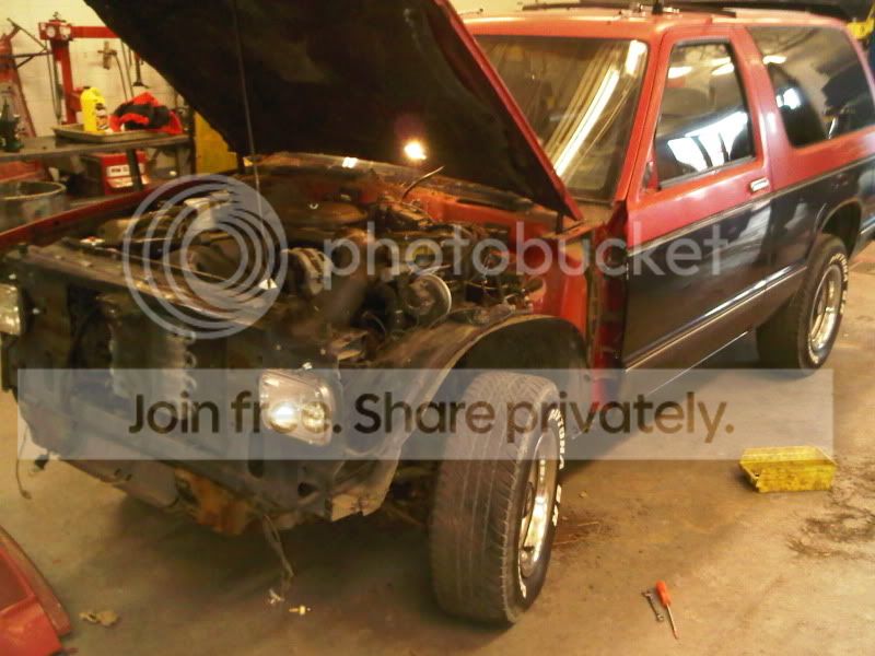

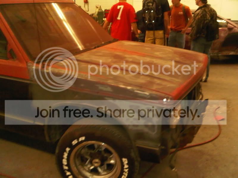

Well today was somewhat "productive". Got wiper-arms off, front fender, mirrors, and started on the fender. I'm not sure what is left to the fender as I have removed all the bolts I can see....next step is to remove the fender well with it to see if it comes out.
Picture update for today...
The fender is all loose on the front, just not by the door. I can wiggle is but something is still holding it. Looks like the panel by the window has to come off so that is for tomorrow. Think it has 2 bolts still holding it on.
for the fender bolts you can't find, check the door sill where the door hinges are. Most of the fenders that I have removed have a bolt located in the upper corner near the windshield. Also, sometimes the lower corner also. Hope this helps.
Yep I got the two that you have to open the door to remove. Also got the one that holds the strip in but from what I have read that strip has to come off also. Going to try that tomorrow.....

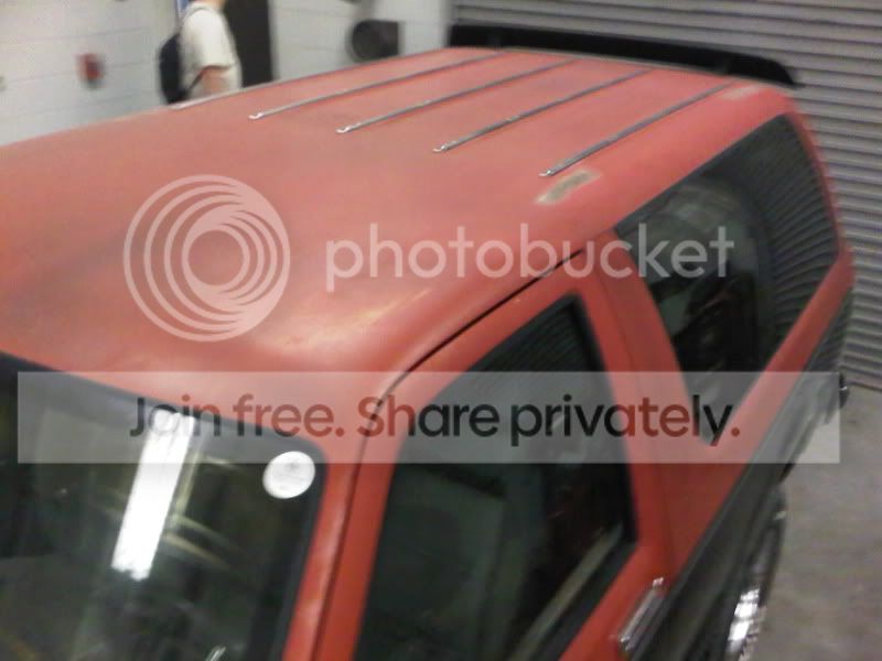

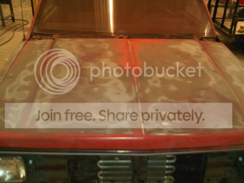

Got a lot done today. Almost finished the hood (indention's, etc). Got the passenger side almost done, gotta remove the trim pieces and get from those down and started on the tailgate some. Going to do the roof/cracks last as those will be the hardest and most time consuming. Hope to have ALL sanding done before the end of next week. Then we will start priming and painting the week after.
