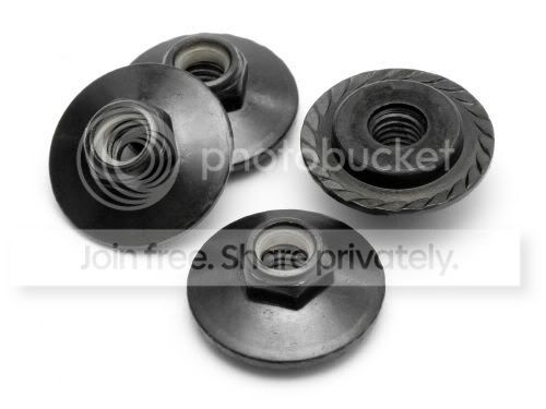

If you are currently using this style nut, you should be ok:

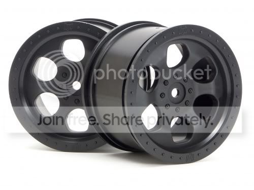

Here is the old wheels:
Here are the new wheels:
Those flanged nuts (which I think is what basically all savages come with now?) have a part on the back side that fills the void between the large hole in the wheel and the smaller stock axle diameter. Those flanged nuts are used with wheels like the ones in the lower picture seen above.
The lower wheels will work with the integy deal I posted earlier. I'm not to concerned about the offset (they have them in 6mm 12mm and 18mm though), as much as I am the durability and usefullness. I like the dual offset wheels the best, but they only sell the one style I think? If they sold dual offset dish wheels I'd defintely get them instead I think.
Back to the integy thing. They look like they would work, but I just wanted to hear it first hand from somebody who has them.
Ahh, I see the difference. I have no experience with the older stuff so I'm not aware of all these little differences that have been changed over the years. Thanks for the info. Great pics for illustrating your point BTW, +REP!

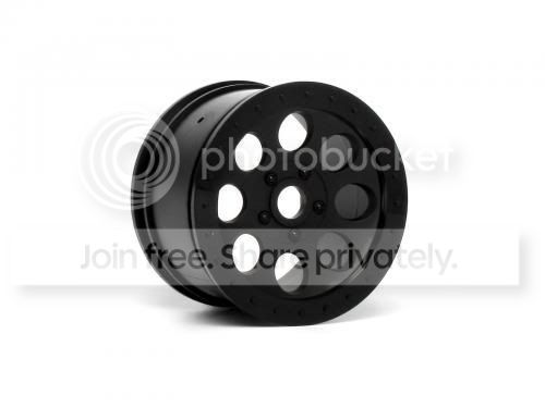

Hmm, do they actually feel solid, or do they feel as much like an after thought as they look like. I like the idea, but obviously the right way to do it is this :
http://www.hpiracing.com/products/en/87229/

they work sweet for big air. They are what stopped me from breaking hexes. 17mm would crack at the corners for me. they do blow out over time but the rims stay 100% that was my focus in the first place. I liked my dynamite 23mms adapters more then my proline. I killed 1 set of proline already but my dynas are still going strong
