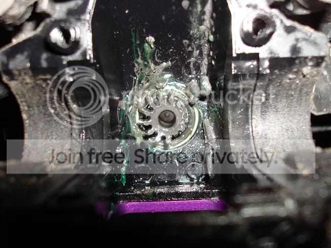

Did some backflips today and heard a big KLANK and had no rear drive.
Haven't had time to take it apart yet. But what is most likely to have broken?
I think it's my rear diff gears. If push it forward the engine takes for half a turn and then looses drive again.
i vote diff. any vid of them flips?

Thanks for the advices, i will take it apart tomorrow ;)

that's is a common problem. the remedy for this would be to either get the hpi bullet proof diffs or replace the broken part and shim the diffs good and you should have any problems.

hey guys, i've not been around for quite a long time.. juz wanna share dat i broke my rear diff too tho i was landing without throttle.. but the tyre was still spinning due to momentum becoz at that moment becoz i was finishing a double backflip.. and that alone can kill diff.. this one is old flux diff, not bulletproof..
anyway, i dunno if this is much concern but recently i destroyed my stock drive gear (86097) and i replace it with HD version (102514).. i juz want to suggest all flux owner to have this part as spare juz in case they explode while ur LiPo still full..
Yeah, that's the original diff for the Flux. They upgraded the newer Fluxes with the Bulletproof diff. Call HPI, and they will probably send you the Bulletproof pinion and ring gear set for free.
