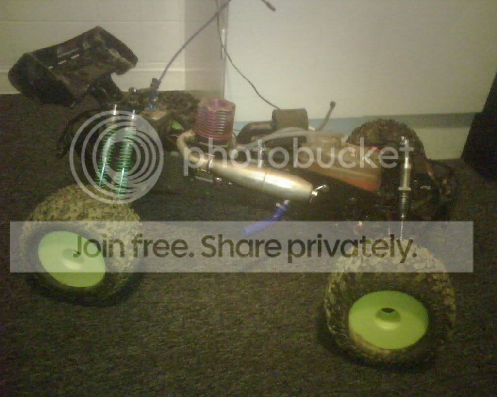

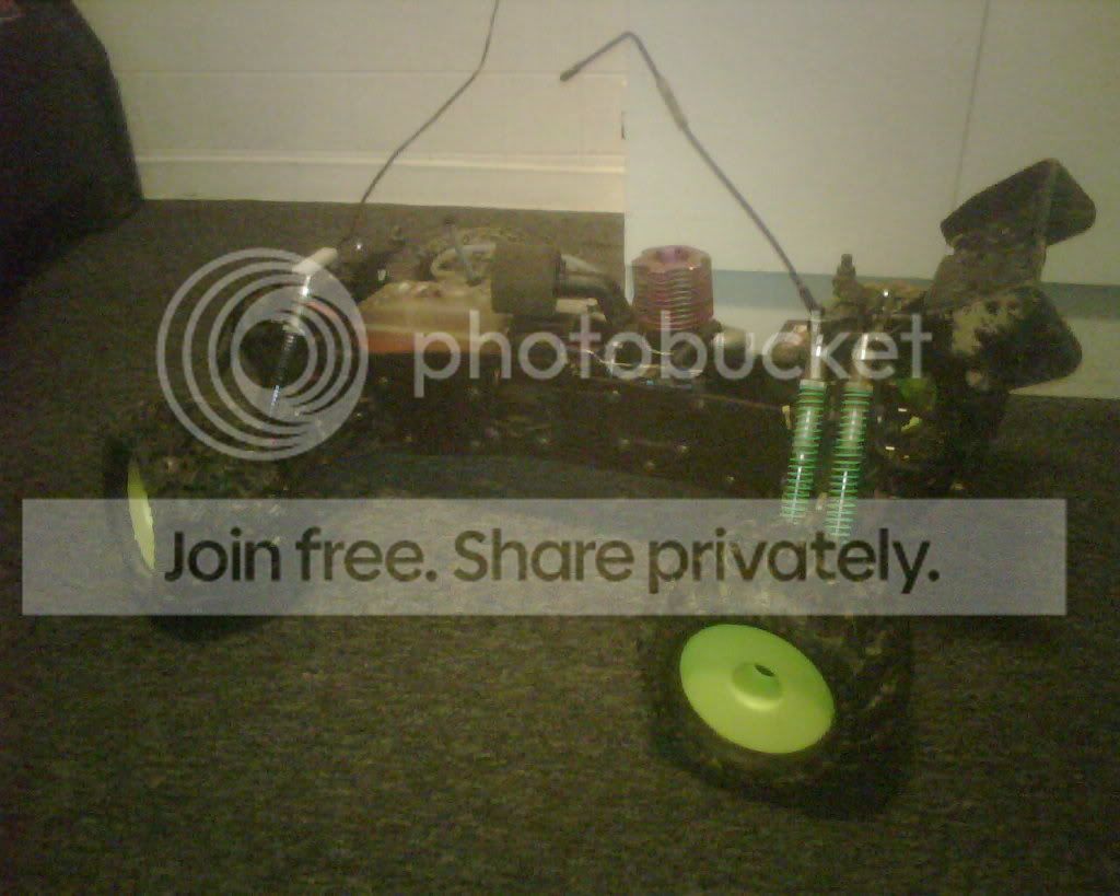

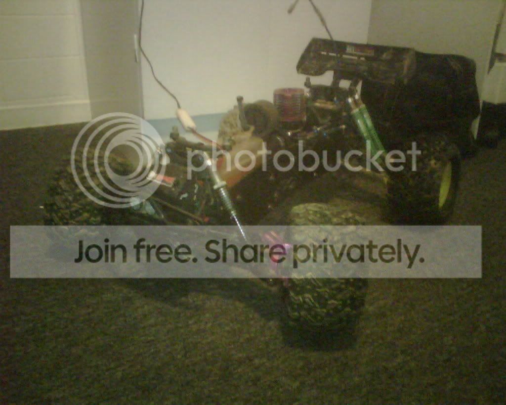

Okay have a issue. The Blue groove wing mount kit doesn't work very well with the BB shocks. You can mount them on any of the bottom three holes but that causes you to raise your ride hight quite a bit. So much infact that the suspension travel won't alow the truck to bottom out it stops about a 1/4 inch off the ground. I am working on getting this fixed. Turning them upside down solves the problem and lets you mount them where ever on the mounts on the top but requires you to cut the front part of the shock mounts on the lower Arm. This worries me a bit.
Second thing I am dealing with is the steering linkage. There is alot of play in it. I am going to measure out and get lunsford turnbuckles with ballstuds and a FLM cross member and see if that helps any.
Truck has had two big changes.
Ercm picco .28 has been sold and replaced with my old picco .26 and the ERCM pipe is gone as well and I either run a THS pipe or and 086 depending. Truck still halls but isn't as loud.
More crappy BlackBerry photos
how do you like the zombie max tires?
I've ran these tires before and have liked them.
