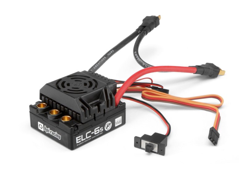

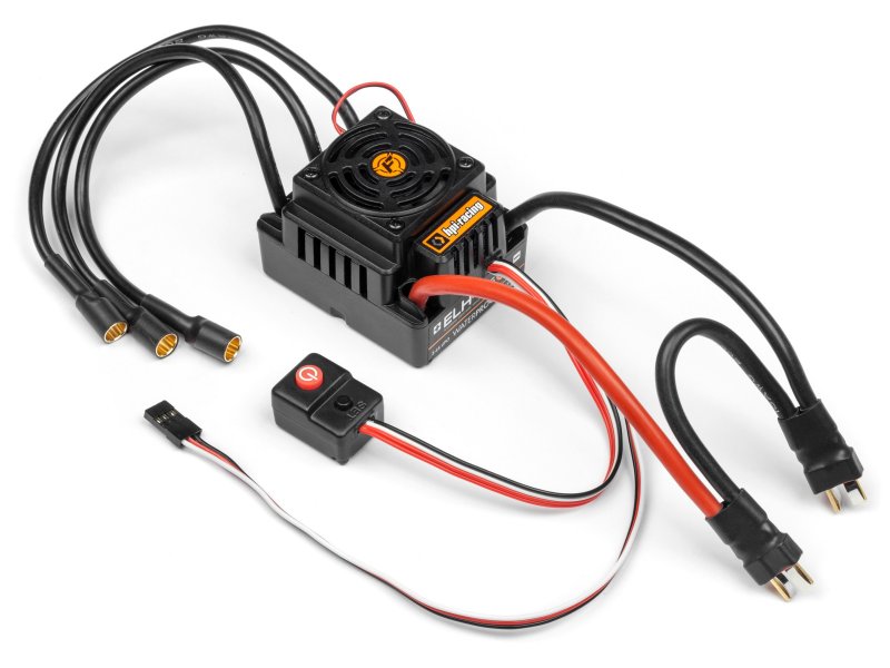

That esc does look a lot like the hobbywing ones. At least the power/setup switch does. The castle ones I've had so far are just a typical switch that you can cut off and solder so you don't have to have a switch. But the hobby wing one has the reset button as part of the switch module.
If I had to guess, the elh-6s is a hobbywing and the elc-6s is castle. Just looking at the switch, wires and shape of it.
elc-6s:
elh-6s:
