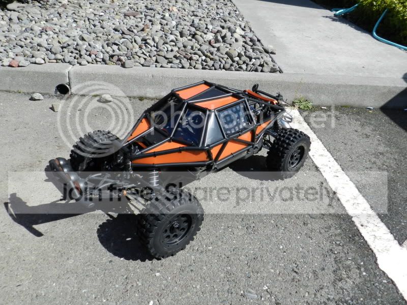

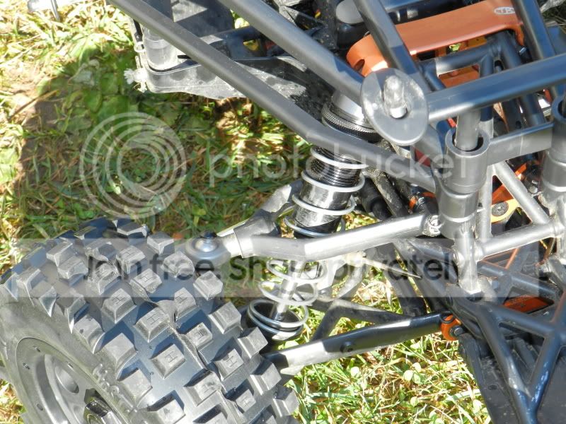

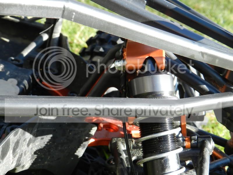

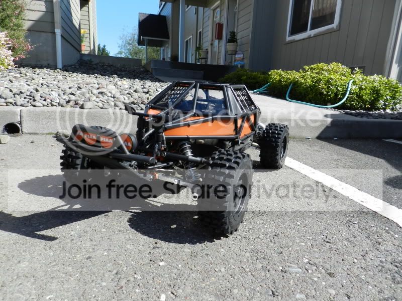

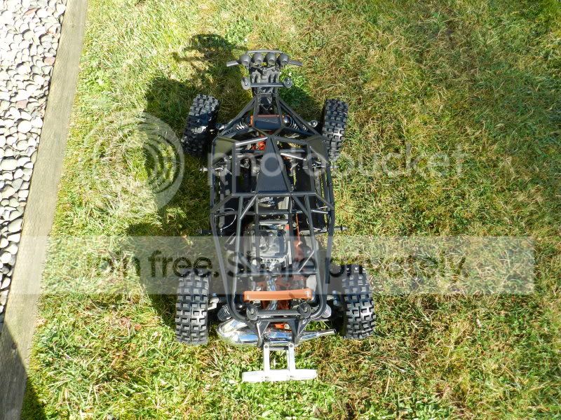

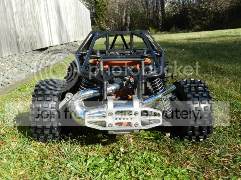

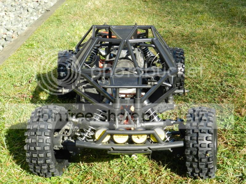

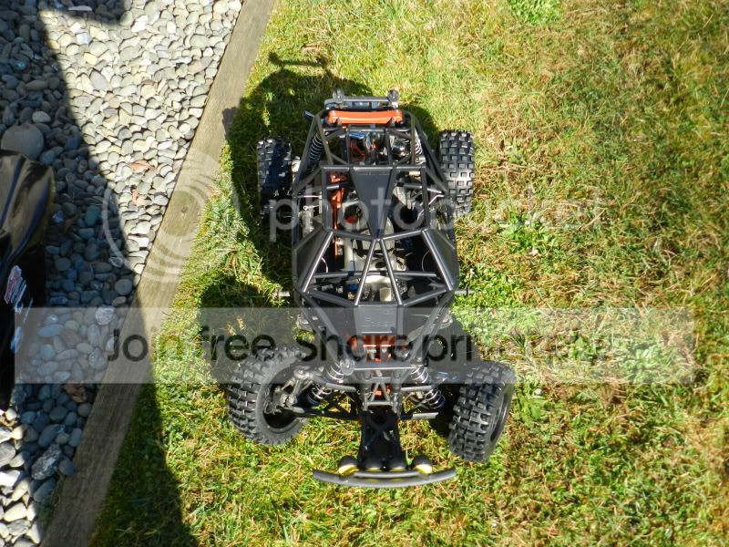

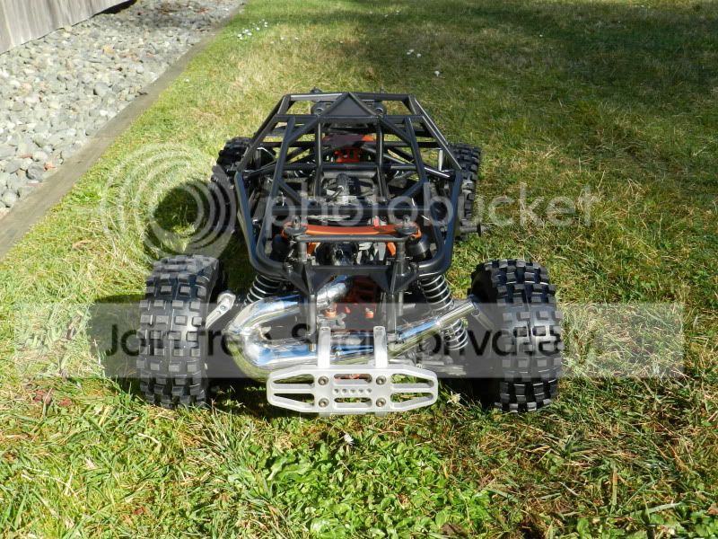

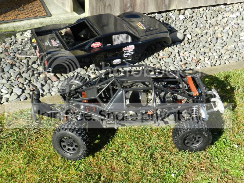

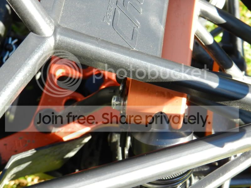

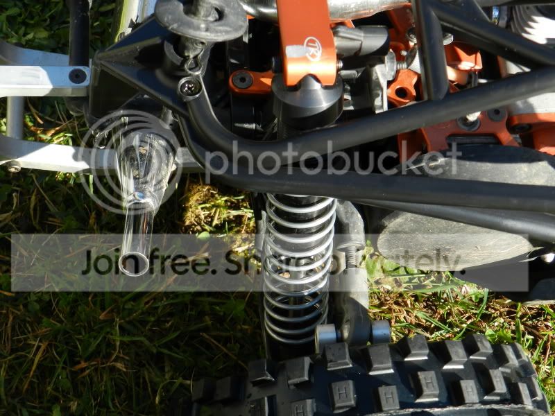

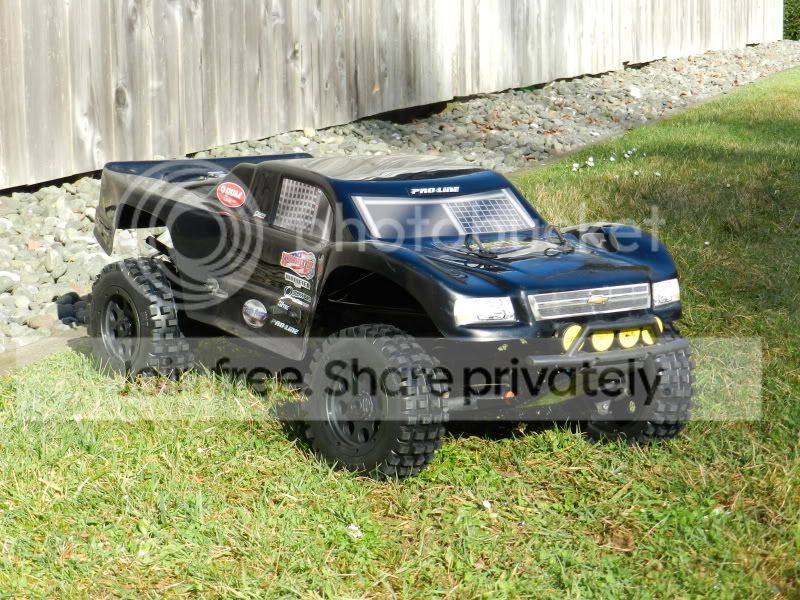

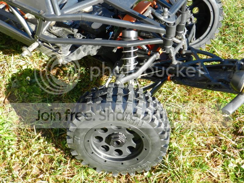

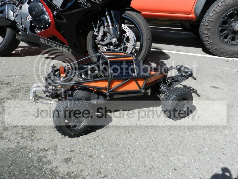

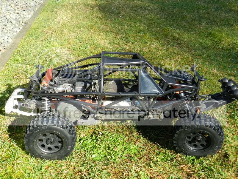

So I added some new items to my truck. Team Chase roll cage with TFE clip tethers, Innovative RC Big Bore shocks in black, 30wt silicone shock oil in front and 40 wt in the rear, full set of Hostile MXT's on 5T wheels with Silverback lipped outers, and inner beadlocks, and rebuilt a new pull start with the Killer RC SSSS and a DDM metal pawl (hopefully this on lasts me until TR comes out the their V2 pull start). I'm gonna make some nods to get the body down at least another half inch, and I'm gonna make some colored panels for the TC cage. I also ordered the Pitbull RC inner fenders for the cage but they aren't available right now, hopefully Rene (Pitbull RC) will be back in good health and these will be available again in the future! I did have to cut down the upper Innovative RC shock mount adapters to make them fit inside the TR shock mounts but it wasn't too bad. Just used a cutoff wheel and a sanding drum in my dremel.
They are awesome dude! Made such a big difference in the truck bottoming out, I haven't had a chance to run it yet. 5 minutes ago teh dang pull start I just rebuilt snapped on the first pull! The white spool spilt right in two! the only plastic that was left inside of it. So of course it had to break on me right?
it is murphys law . what can go wrong will go wrong. i havnt heard good things about the metal pawls either tho. they can ruin a fly wheel. me ill stick to stock as i have gotten it down to under 5 mins to rebuild them
One nice truck Mike. Those shafts on those IRC shock are huge. When I 1st that cage I thought thats the cage to have. Nice going.
looks awesome mike, it keeps getting better and better, Whats next?
I think the shock shafts are 8mm if I remember right lol. Next is the Turtle Racing V2 pull start, as soon as they are available! I'm sick of pull start problems, going all the way back to the savage. Now I am having them with the new 28.5 for some reason. It doesn't even have a ton of compression by some standards. After that I will be thinking about full mod motor, and gearing options. But that won't be for a while, I am pretty darn happy with this CY 2 bolt with the 28.5cc head kit and zenoah crank. I would like something with a 4 bolt head but when I do I'm gonna go all out with it. Sorta thinking about a 29.5 FM LR, or a 30.5 FM LR. I like RPM's but I do run at the dunes quite a bit. Can't really decide yet.

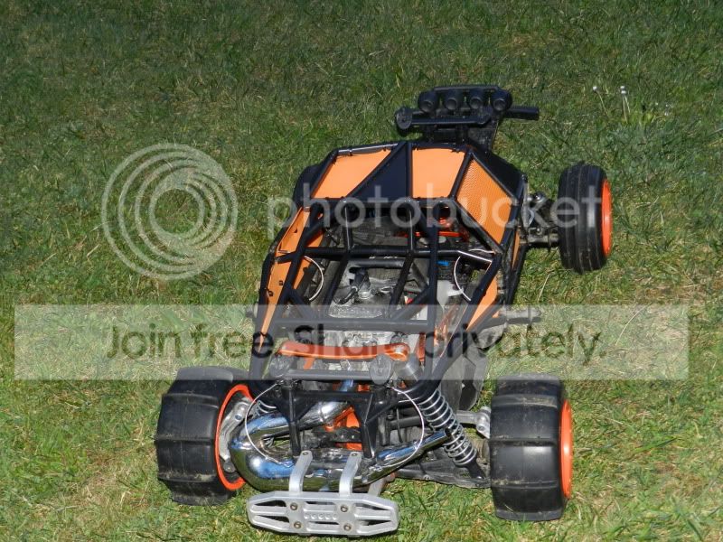

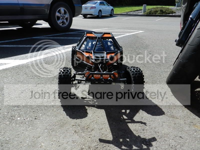

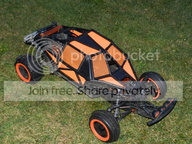

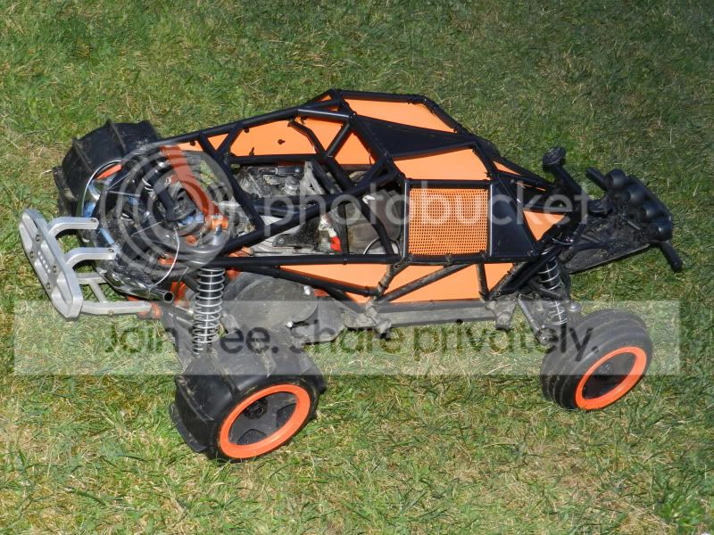

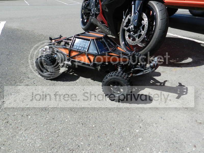

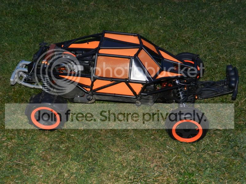

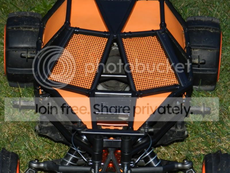

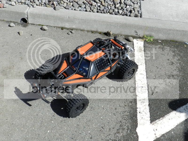

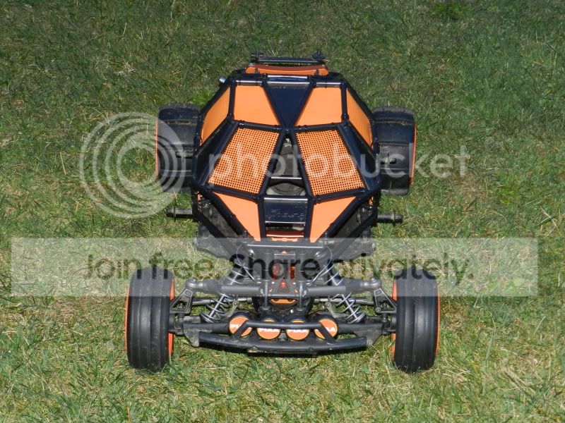

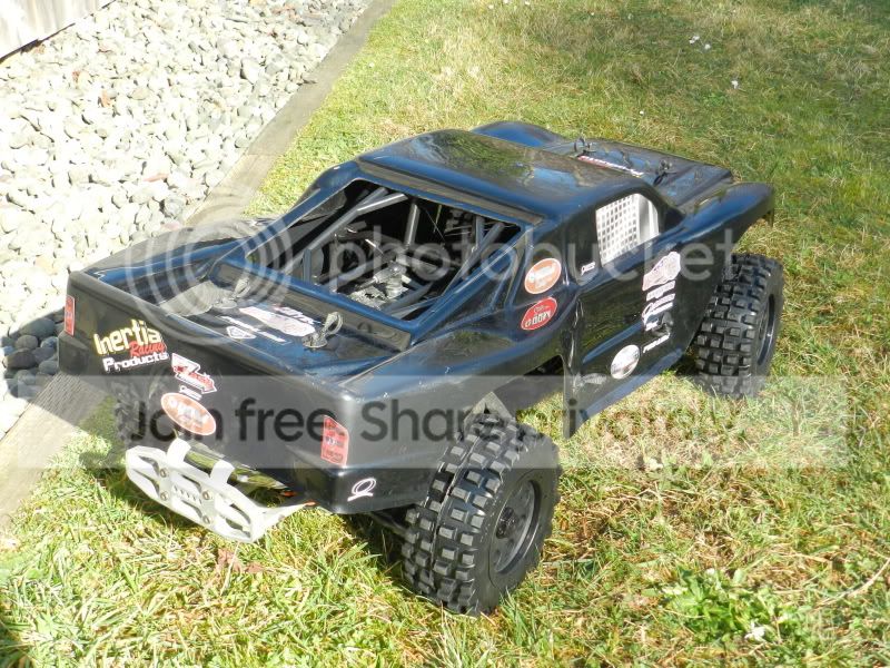

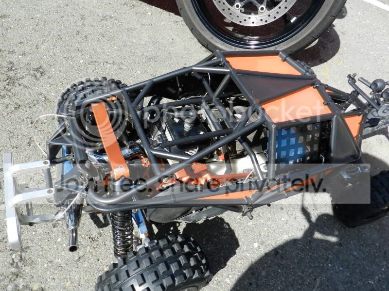

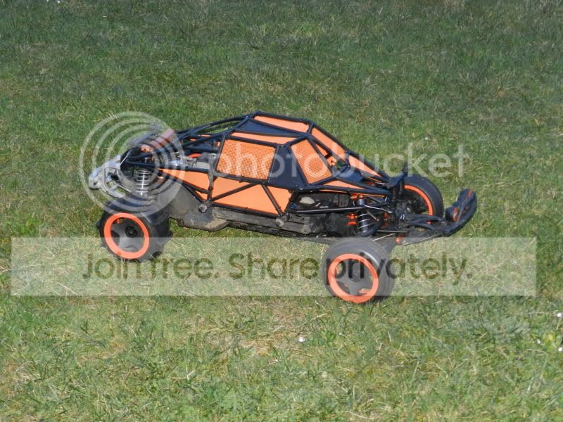

Redid my panels with 1/8" lexan painted orange with black backing and added a TNT window/windshield kit. Added HD rear springs, Phatdad engine Brace kit and a few small odds and ends that you can't see like the TFE ball link/cone combo.
The lexan makes it easier to wash than the meterial I used before and the color is closer to all the anodized stuff inside the truck. Added a Turtle V2 pull start also. My truck is filthy cause of the rain but you get the point lol.
