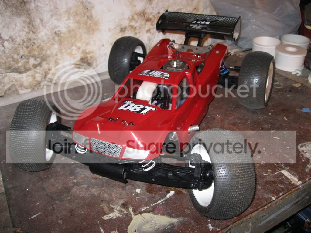

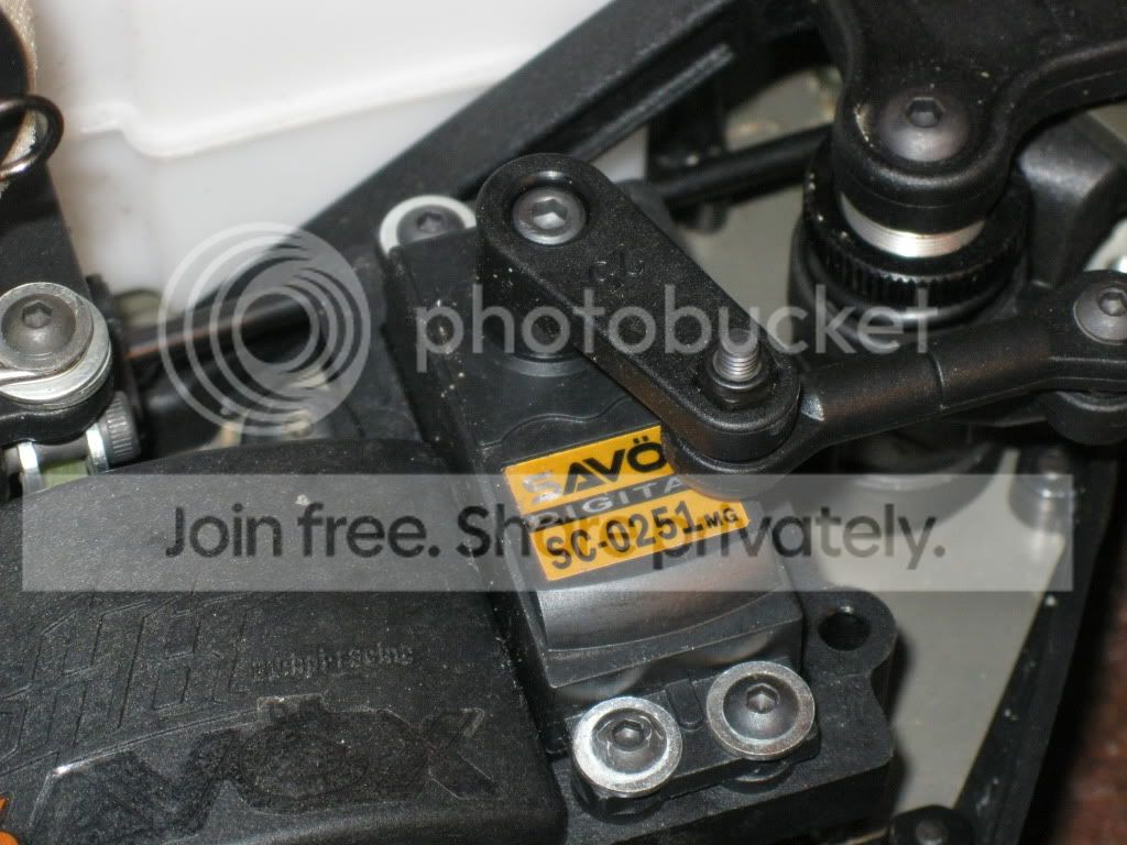

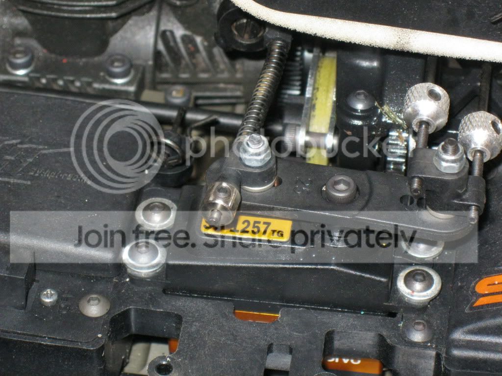

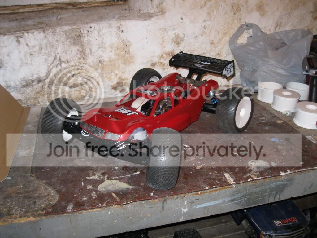

well as most of you know i picked up a new d8t and wanting to build it i forgot to take pics of the build. here it is all ready to go and some action shots. I'm using all savox servos in it (will do a review on them once i get some milage on them) they feel good, better then any servo i have ever run. also running a pullstart axial for now. well on to the pics

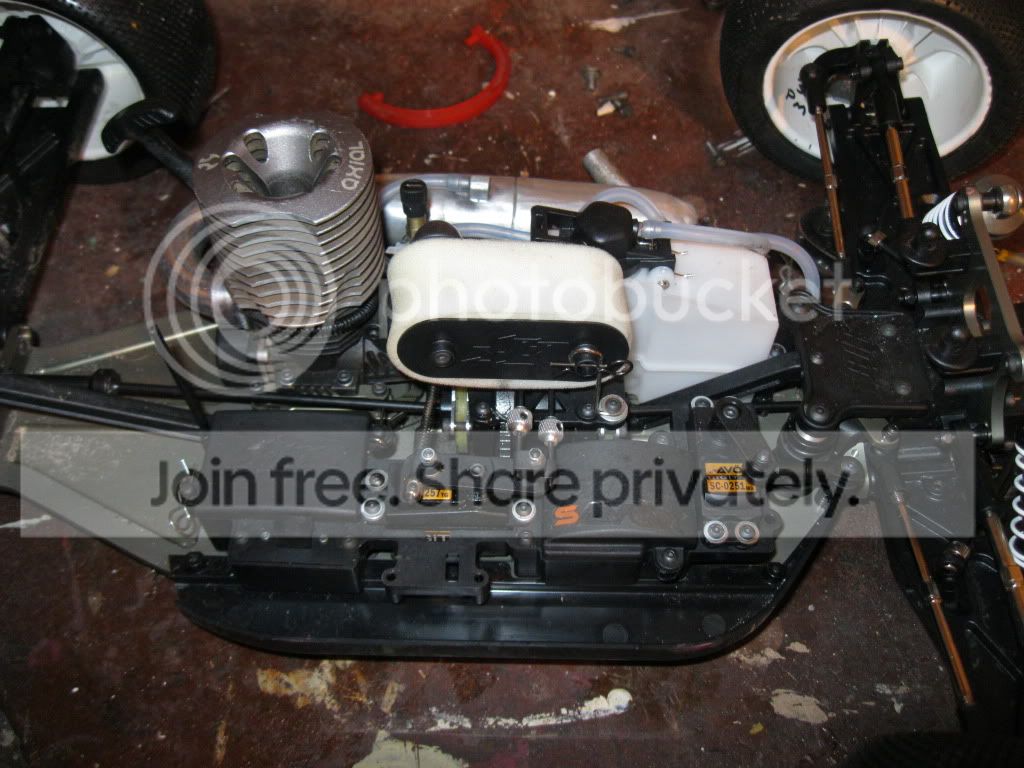

hey mickey how did u mod the motor mount to run a pullstart pm me

it was easy to mod the mount red. i cut the rear crosssection off of it. then i shaved the backplate and pullstart assembly of the motor to fit in between the mount. then a couple of shims between the mount and chassis, voila pullstart
