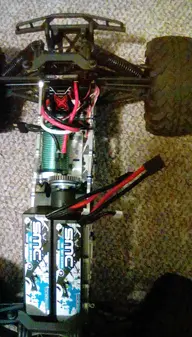

Here's how I did mine haven't had any issue's with the esc getting damaged . Except for a very hard landing where the double sided tap let loose and the esc fell off luckily all was ok.
Mine is in the stock location on the Flux HP esc plate. I have it ziptied twice (left/right, front/rear) as well as double sided tape. I did have just one ziptie going left to right, but after a hard nose landing, the esc slid forward about 1/2", so I put new double tape and 2 zipties on it. Don't want my MMX wires getting ground up in the spur!
