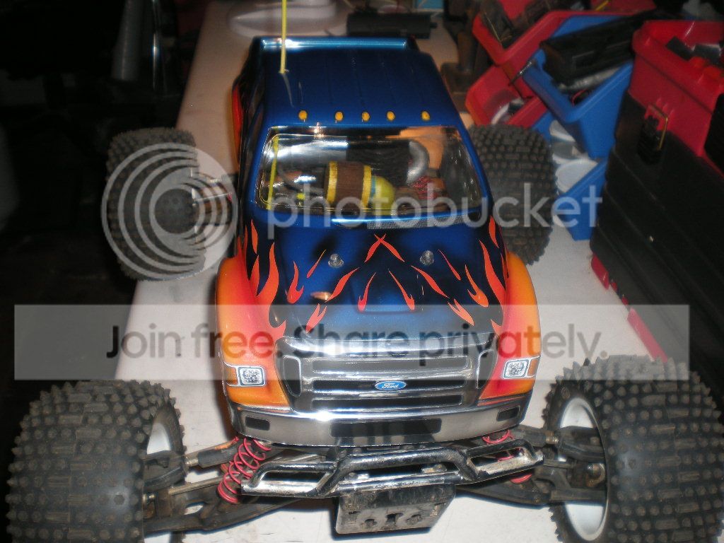

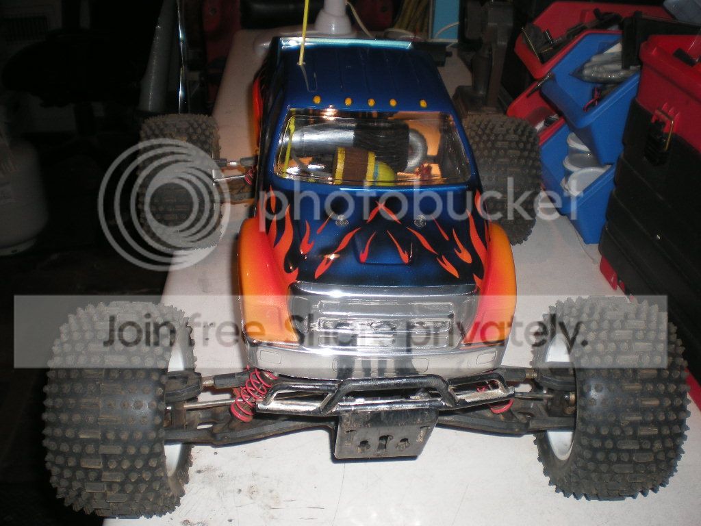

Been a long time since I used spray cans... ;) been airbrushing all my stuff for years but the same principal using dry (light) coats, then use wet coats (heavier spray) to do the same thing...
I use Alclad chrome paint, it shines just like chrome does and as long as you apply it right it lasts and lasts without turning to aluminum look....
I painted that stuff there over 4 years ago and it still shines to this day and I aint easy on bashing my trucks :lmao:
