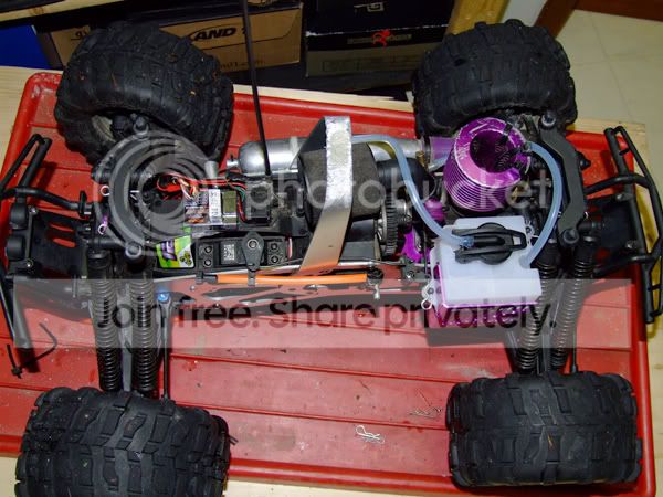

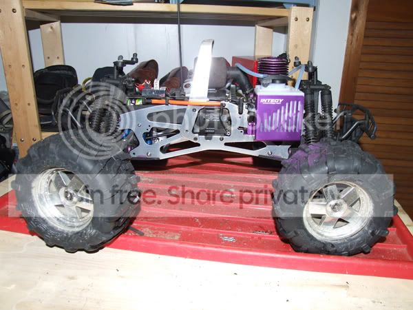

So far i upgraded:
Steering saver aluminium
Gas Tank gaurd
Hitec servo 645
and 6v batter hump pack
here pic of my savage!

I would keep your current arms or get RPM arms, as for the chassis that is what your prefer, but FLM does have a warranty on their parts (a little to bling for me; I like IRC myself).
For your tierods always poping, put some washers on the screws that hold the tierods to the truck (bulkheads-hubs)
alloy bulks are nice, cuz if you break the plastic ones, it's a pain to replace them...
BAH!! the plastic arms will break before the alloy bulk will...and they're cheap to replace, and alot easier than tearing the rig down to the diffs, to change the bulks...
