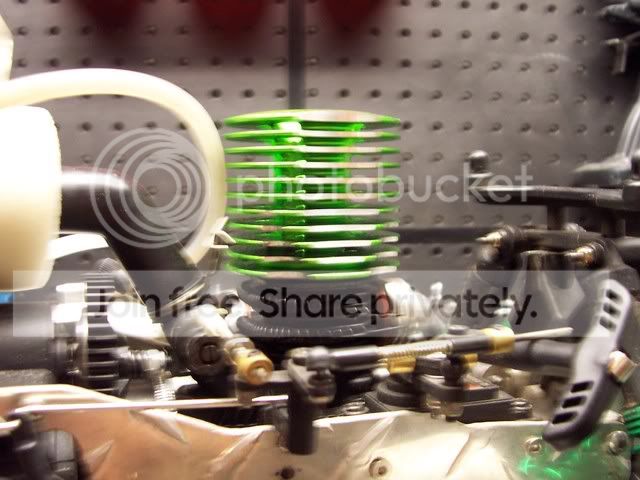

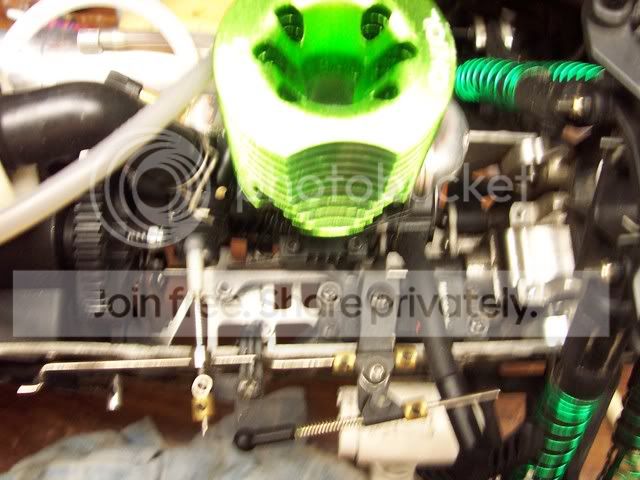

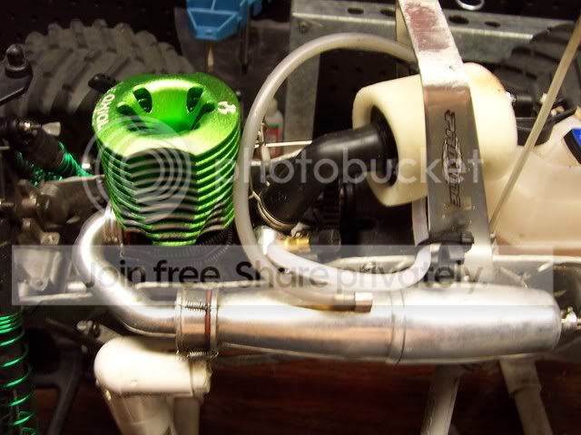

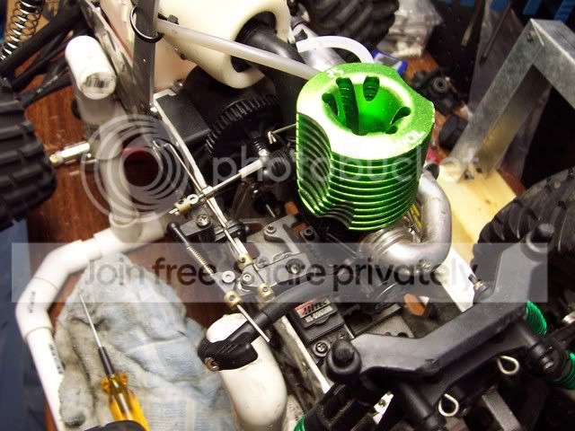

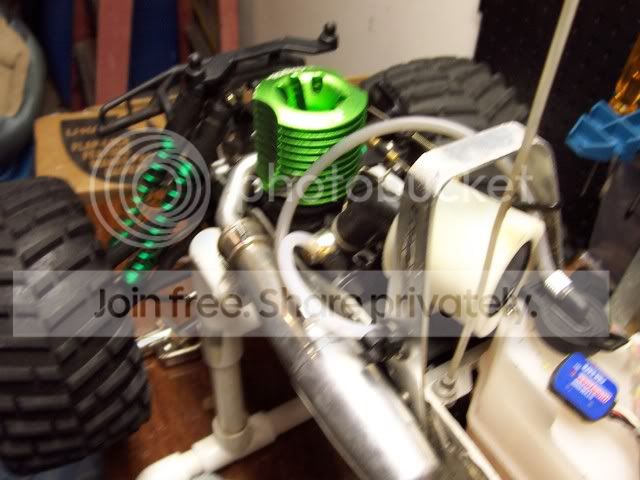

Here are some pics of the motor mounted in my savvy and how I have the throttle linkage and everything set-up.
Enjoy....
