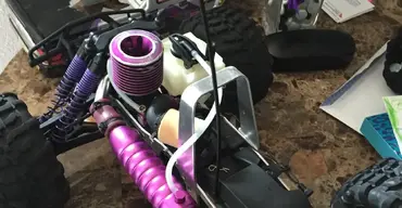

hello I was wondering what the plate is called where the glow plug goes into? I have a HPI savage .25.
That would be the cooling head. Is there an issue with yours? If you give us a picture of your engine (to see which version of the .25 you have) we can help you better.
I don't have a really good picture but here it is. The glow plug isn't tighting down I think it's striped.

Head Button is more the common name for the part that holds the glow plug in place, most are replaceable so you do not have to replace the whole head....
