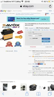

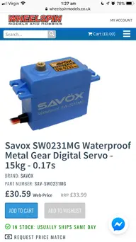

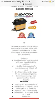

Since then I’ve had a look and have come across 2 servos that I like, both are made by savox.
I am not sure wether the extra £30 between these 2 servos - will I see a massive difference in performance ? Is it worth paying that extra £30?
Do I really even need the servo that has 277 torque for what I want to use my buggy for ?
I am using a 6v battery
Currently I have the following servos
Hpi sf-2 , hpi sf-5 and hpi sf-10 all NOT waterproof
So anything new which is 10 times better than these would be good
Out of the 2 servo which would you recommend ?
Option 1
Spec:
Spec Check:
  • Dimensions(mm): 41.8x20.2x42.9
  • Weight(g): 66
  • Speed(@6.0V sec/60): .17
  • Torque(@6.0V oz-in): 208.0 (15kg)
  • Gear: Metal
  • Bearing: 2BB
  • Case: Plastic
  • 25 Tooth Spline
Option 2
Spec
  • Dimensions(mm): 40.6x20.7x42.0
  • Weight(g): 71
  • Speed(@4.8V sec/60): .18
  • Torque(@4.8V oz-in): 222.2
  • Speed(@6.0V sec/60): .15
  • Torque(@6.0V oz-in): 277.7
  • Gear: Unique Steel
  • Bearing: 2BB
  • Case: Aluminum
NitroNick
96
Honesty either of these would be totally fine. They are both waterproof and have over 200oz of torque, the extra 70oz of torque is cool but I really don’t think you’ll miss it. And the alloy case is neat, but again unessasary.
I feel like the first option is the better deal here. And yeah like you said either one of these is going to be a HUGE upgrade over stock, that’s for sure!
