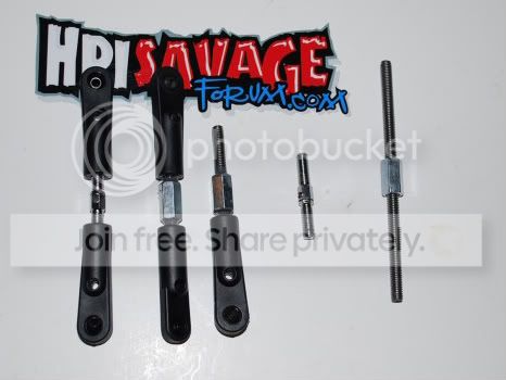

Here is one way to make an upper arm that will work with the rsc cross brace that alza is going to make.
parts needed for each arm:
2 x hellfire ends (or end of an ss arm)
1 x 5mm threaded rod ($1.10 at my local hardware)
1 x connector nut ($.60 at l-hw-store)
1 x pack Aluminum Washers 3x6x3mm HPI Z819 ($5 shipped)
jb weld
the rod threaded 18 mm into the rod end and i left appx 20mm in the middle to get the max camber i would ever want. then i jb-welded the connector nut.
the pros are that you get a stronger upper a-arm because the rod threads a lot further into the end than does the stock connector.
the only con i see is that you will need to unbolt one end of the arm to adj camber (not really a big deal to me), but the connector nut will help make the adj on each end.
haven't seen any pics as of yet of the cross brace... if these work with the GH BUlks ill get them, but i doubt they will fit...
he would have to mill the middle thinner to get them to work on the gh.
i forgot to mention you need a pack of Aluminum Washers 3x6x3mm HPI Z819 and use 2/ arm where they mount to the brace so they stand off.
you can see the washers between the arm and the brace here
because of the diameter of the shocks, i mounted to the outside of the a-arm so they wouldnt contact/bind with the a-arms
I'm happy with the way the arms turned out - especially how strong they feel with the 5mm rod threaded all the way into the rod ends. the arms are smooth through the whole range of travel with no binding. Also happy that i didnt drop $150 on the RSC just to have the bolts tear the threads out of the carriers.
