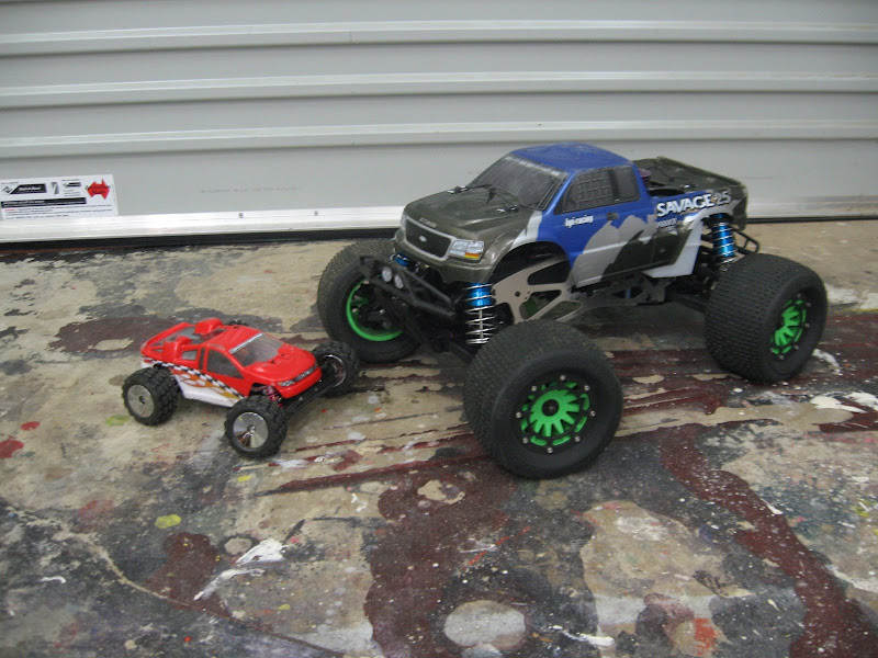

So I rebuilt my nitro savage with a few upgrades. It has been in bits for a long time now but it is finally back together for a while any way. My savage was really run down. The drive cups all had 2 or 3mm of wear on them meaning there was a huge amount of slop in the drive train. Any way after buying a heap of parts from rob at nitronutzz and a heap from smf as well I have put it back together. It is now running a lot of savage x plastic. I also put on a set of losi shocks and upped the spur gear to a 52t. It now has a lot more take off which is nice as the engine was lacking in power and also moved the clutch bell away from the brakes and the carb away from the fuel tank. Here is a pic next to the mighty mini t which has also just got a bunch of upgrades:
I took it out and spent a long time re adjusting the shift points. A strange thing happened though. I cut some holes in my tires as the maximizer rims seal air tight. I though that my tires might tear though after doing this. Sure enough before I even had the shift points set I had a big hole in one of my tires. Thing was though the hole was no where near where I had cut the holes. Turned out to be bad luck. I clipped a treated pine log with a back tire and it splintered when I hit it. Now I need a new set of tires :$broke:.

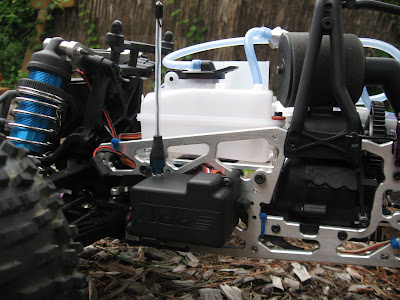

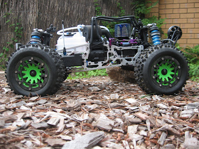

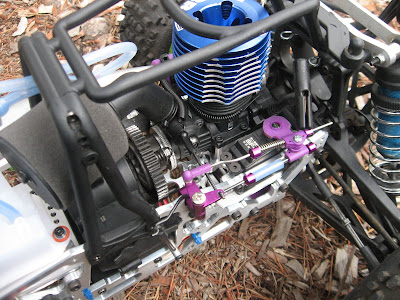

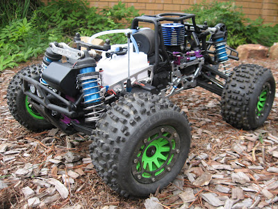

So I finally got our camera back so I can post some piccies.
A few little things on the midtank mod:
1.The fuel tank posts I used came with the FLM servo plate. I think they are actually servo mounts but 2 stacked on top of each other were the perfect height for the tank. The screws used to hold the tank are 2 stock shock tower screws with some washers and some GMK fatboys underneath.
2.The RPM box is a perfect fit for the Spektrum SR3000 receiver. If the receiver could be a little taller and longer and still fit definitely not wider.
3. The HPI battery box is a bit on the small side. My receiver pack did fit but it's a squeeze and it wasn't easy. Innovative RC now offer another mount for a different radio box which might be worth a try.
The only thing I am not really happy with is the wiring. There has to be a better way. I also want to move the hump pack back behind the rpm box. There is a heap of space in there and I think it will get crushed where it is. I also have to find a place for a switch. At the moment I am just unplugging the hump pack.
Any questions on the Mid Tank just ask. Any suggestions, please tell. I am happy to take extra photos of something if someone wants. There are more photos in my picasa gallery if you click the photos. I couldn't be bothered doing a write up of how I did the mod. It's fairly simple using the shopping list from up the top really. If I had had our camera while I was doing it I probably would have done a write up but the finished pics show pretty much all of it.
