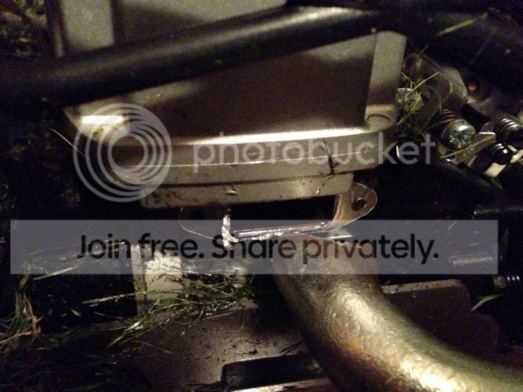

Sorry it took a couple tries to get photo. The damage is not from an accident it's from just running in an open yard. The only thing that holds the exhaust is the flange to the head and a spring type mount to the frame, I think it's stress from vibration and will happen again.
It looks like a bit of the header/ flange is missing? Was it so brittle that bits were just falling off?
Looks kind of like the material is very thin there where the flange and header meet up.... hope HPI makes it right for you....

Got one on the way from eBay, yeah there on back-order so what does that tell ya? There must be a problem with the design I say. It needs more support, the weight of the entire exhaust rests on that thin metal flange and a spring type support on the end of the pipe. So all the engine vibration is focused on that point, it will stress, work harden and crack. That's just how metal behaves, So I spent money with a free one on the way, well I want to run my truck so at least this way there will be a spare when the next one fails.
I would remove the spring mount on the pipe and mount it solid so it has less chance of cracking at the flange again, i am not sure why they would have put a spring mount on such a heavy item like the pipe... Good Luck with it and hope it was a fluke break at this time....
