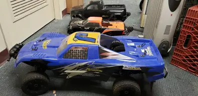

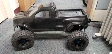

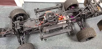

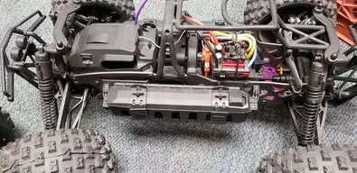

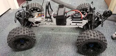

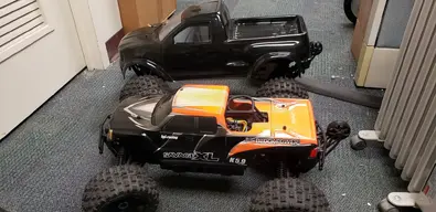

I have personally converted all of my Savages to electric and continue to but some from the boxes of spare parts that I still have. The Savage was KING for a very long time and for a reason, it will always be that truck you wish you had in your collection. Here are just a few that I have converted from Nitro or built from spare parts. I currently work on two more Savages and will post them once done. I also love to build them as you can tell....lol20210208_121303.webp20210208_121546.webp20210208_121610.webp20210208_121842.webp20210208_122118.webp20210208_121759.webp
