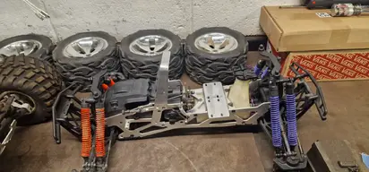

Hi how's it going all? Dare I say it but I've a funny feeling this could be my first bit of activity, well more of an interaction than anything on here. I've been into nitro rc's for a while now I do possess a savage and a half!
I'll drop these pictures on below of the half. It don't match the Hot Bodies Big Twin Truckzilla or the Savage equivalent yet the diff housings, shock towers, gearbox and engine plate are from the savage X4.6 which fitted on with no dramas. So I thought I'd ask here as it would appear that this site has some knowledgeable folk who may be able to identify the chassis.
I cannot find any hall marks or manufacturing stamps to try and help identify it.
It was an ebay purchase about 18 months ago, I can't remember when exactly either.
When I found it listed it was just the tvp's and stiffener, I added the partial running gear. Many thanks in advance and thanks again for reading this far!

Hi Chris and welcome to the forum, your definitely in the right place to be asking question about HPI Savage trucks. Well they aren't Hotbodies Truckzilla TVPs, there were 2 types of truckzilla TVPs and they anit either. they are extended on the rear that is for sure but they look like they have the 6mm front extension aswell. They look like 4mm thick which is another indication they aren't original TVPs as they were 2,5mm standard, whether HPI Savage or HPI Hotbodies Truckzilla. If there is a gap of about 8mm between the front of the gearbox case and the back of the radio box then they are 1" rear & 6mm front extended TVPs. Another indication that they are front extended is if the standard rear 84mm drive shaft fits the front. Also if they are 1" rear extended the rear shaft would be 113mm. these measurements are pin to pin.
Your TVPs look like they were meant to be used with a twin engine setup due to the top rear parts of the rails missing but again not Hotbodies truckzilla twin TVPs.
Hotbodies Truckzilla TVPs designed for the 4.6(7.6cc) side exit exhaust hotbodies engine.
Hotbodies Truckzilla Sport TVPs. Designed for rear exit exhaust.

What you have there is the NewEra savage twin engine chassis,
It’s pretty much a standard length chassis
They along with the Hb chassis are long discontinued,
You’ll probably have to fabricate a engine mounting plate as it’ll be difficult to get the engine plate that fits it now,
I had one myself few years back

The truckzilla chassis were designed for the force .46 engine that had a taller engine block and a side exit exhaust that cleared the chassis,
It’s possible to have the more common 1/8 size engines run a side exhaust on them with the header running through the chassis with a small amount of filing to be done

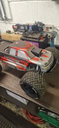

So as promised some additional pictures!
The first picture is of the difference between two twin engine tvps, the top pair are from what I've acquired recently and the lower pair are the ones I questioned the community about.
Second picture is of, well, as one can see it's the "questionable modification" of the fuel tank. Hopefully it won't interfere with fueling.

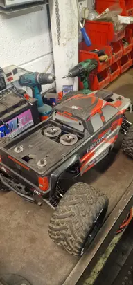

This is the chosen one to kindly donate most of its parts! Also this truck will be making some donations too
