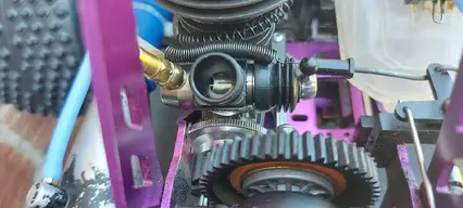

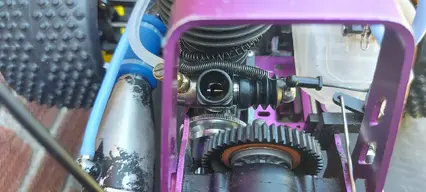

Full throttle and when I let go of brake ,🤞

looks good! I would try to run it now. start with it off the ground on a stand or something. that way if it malfunctions you don't have a runaway truck. let it warm up. if the idle is too high or too low adjust it with the screw, not the linkage. it should be low enough that it won't move when idling but also doesn't just die.

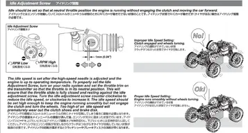

Hi all I now have it running in front of me I can't seem to gave it idle without wheels spinning constantly how do I stop that
ELWOOD
HPISF Supporter
504
So.Cal.
@Tiddy
TURN THE IDLE SCREW COUNTER CLOCK WISE ABOUT 1/32" UNTIL
IT WILL KEEP RUNING WITHOUT TRYING TO MOVE.
THE WHEELS SOMETIMES WILL SPIN IF THE TRUCK ISNT SITTING
ON THE GROUND.
