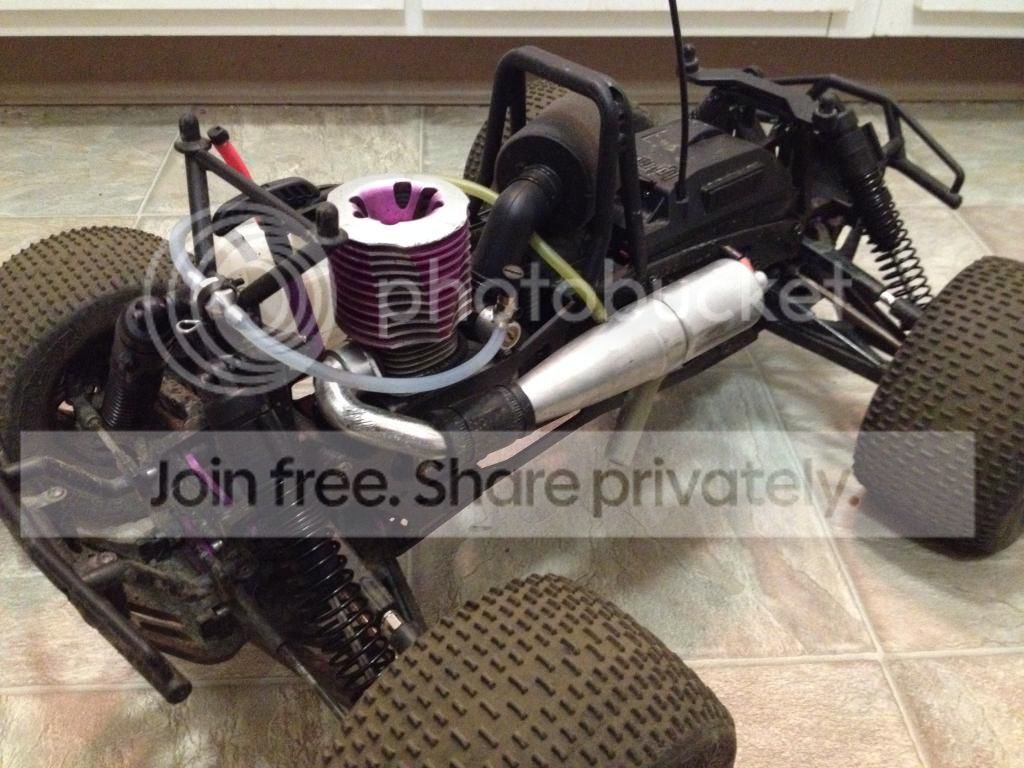

Anyways now that that's out of the way, here's I guess what will serve as the "before" or beginning picture. I had to paint the wheels, they were somewhat chrome haha.

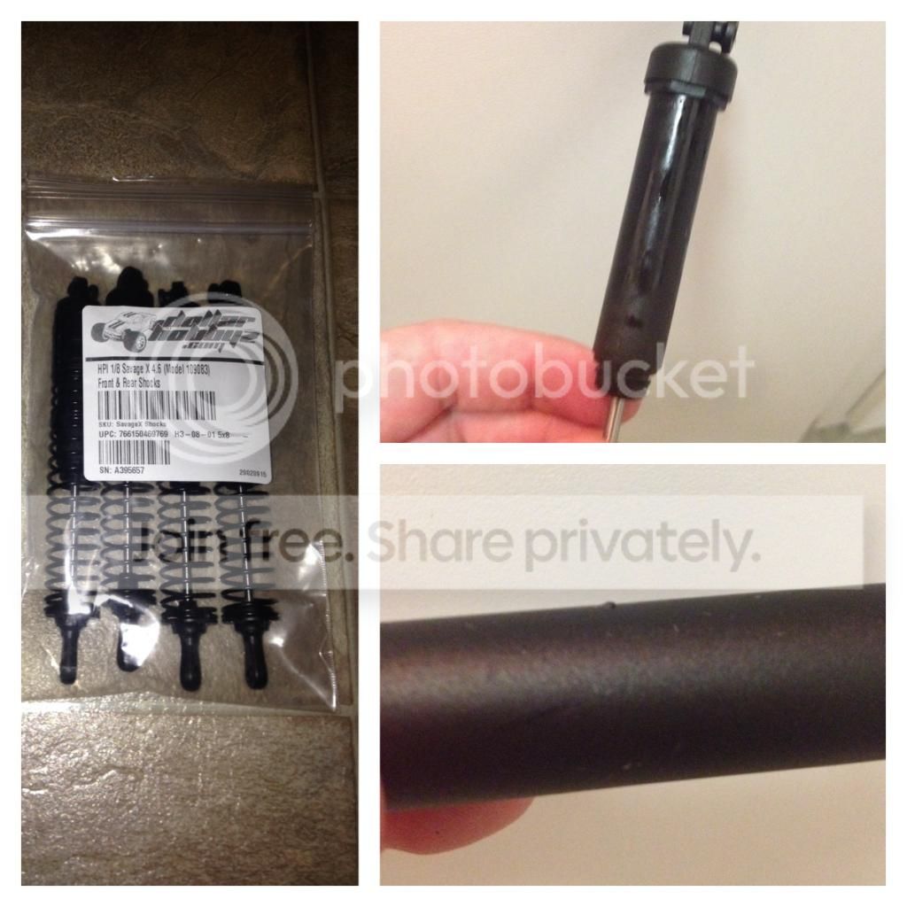

The factory 8 shock set-up was in dire need of a service, 3 or more had slightly bent shafts, and many had various levels of oil in them. I didn't want to waste the o-rings & 40wt on them so I straightened them so they traveled smoothly and refilled them with some 5w-30 just until I picked up the big bores.
They had some oil from assembly under the spacers and such, so I pulled the springs and wiped them down. Also, for anyone buying pre-assembled big bores, be sure nothing is left over from the parts tree on the shock body. In the pic above one can see a little bit of the parts tree not yet removed, a hobby knife cleaned them right up, I had two like this.

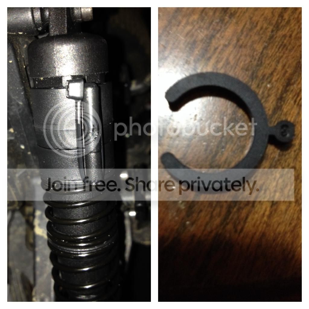

Not sure if this has been done or seen, but I'm OCD when it comes to particular things, one of them being when multiple shock clips become misaligned. It bugs the hell out of me, so much that I try to just run one spacer, or CA them together. However, I noticed the big bore spacers have a decent size recess on the finger hold, and saw an opportunity to use some race-ties 😎. Again, totally useless, but I'm a guy who index's his spark plugs in everything from his modified 302's to his lawnmower.

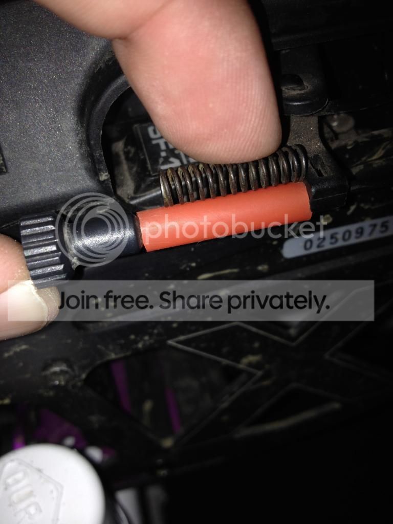

The last update today doesn't really require a picture, but I made the common fuel-line for brake-spring swap. In my ventures through the plethora of Savage info out there, I saw a lot of people asking about, and how long to make the tubing. This is how much longer mine is, works well so far.

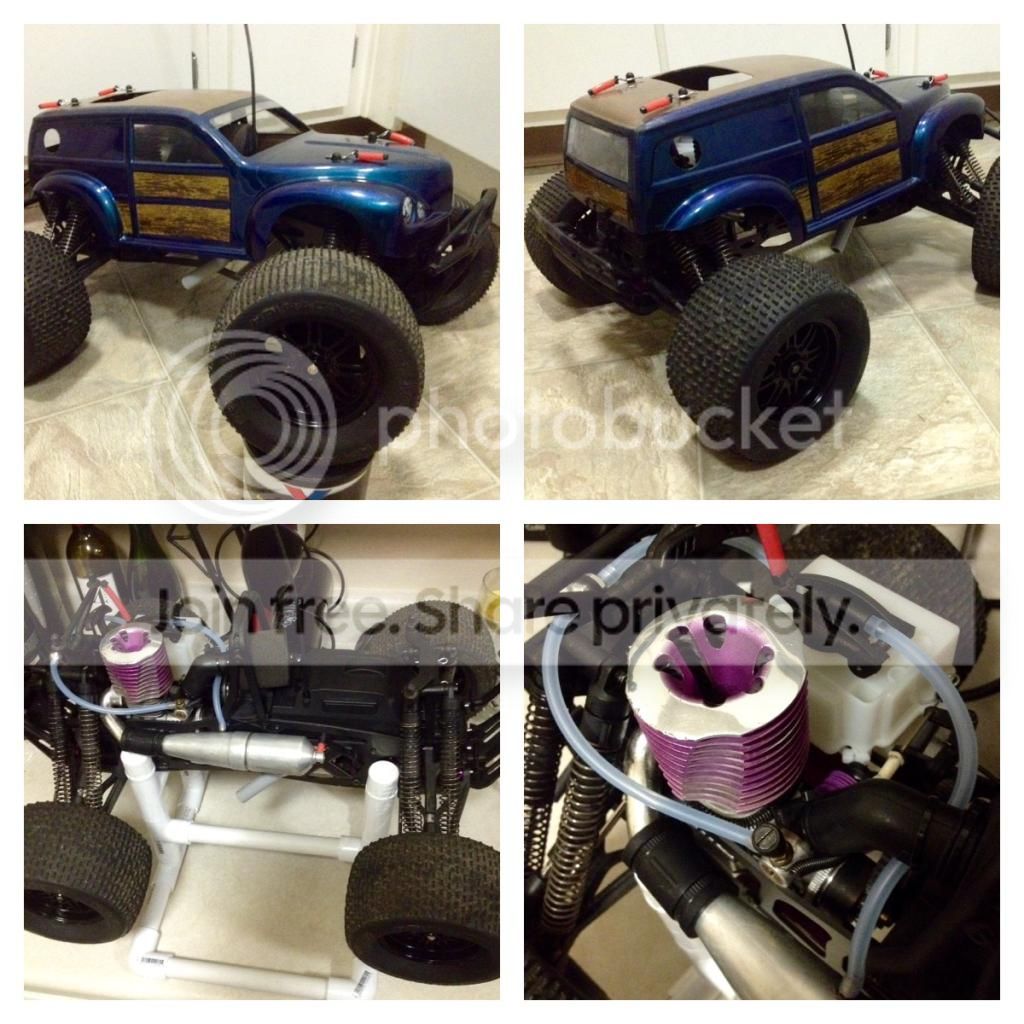

A new body of some sort, not really a fan of the one on it, and I didn't paint it, so I need one thats my own, even if it were a pre-painted lid. But I can't decide.

As to your question with the fuel tube on the linkage, it's variable. Essentially all you are trying to do is provide a solid piece to push off of, instead of the spring which as you know doesn't hit the brakes hard enough. So as long as you can adjust the throw of the servo to work, you're good.

Yeah I was surprised to find the brake spring still on this truck, as its probably 7, 8 or more years old haha. I made it just long enough so that it would be set, and not have thread sticking out of the end, that bugged me too.
