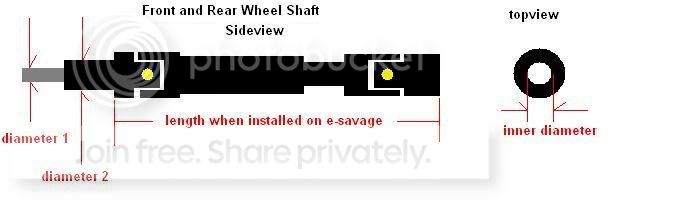

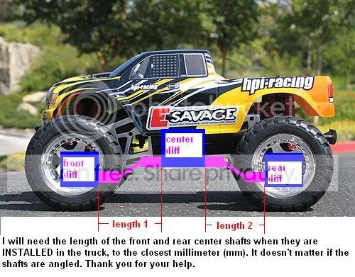

Thank you for contacting GoodsGood Customer Service. Attached to this email is 2 pictures which specifies the measurement which we would like to have.
For Center shaft, it would be length1 and length2.
For the front and rear wheel shaft, we are interested in diameter1&2, length, and inner diameter.

Oh if anyone can Help with these measurements that would be awsome for i don't have the proper tools to do this with ! I don't have a set of mics to do the proper measurements !
HELP US OUT IF YOU CAN ANYONE !!!!!!!!
