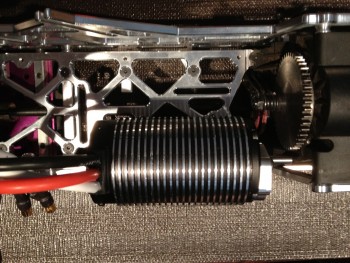

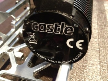

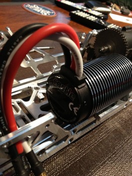

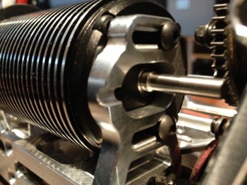

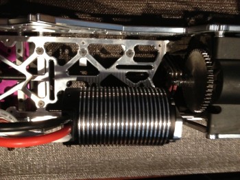

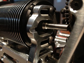

My motor came in. Castle Creations 1717 1650kv. The same one that is in the XO-1. It is too big to fit properly in the FLM engine mount. I plan on fixing that with a dremel and a drill press shortly. The screw holes in the 1717 are m6 instead of m4, so the holes for the screws have to be widened as well.
