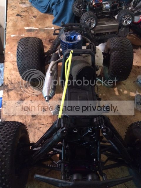

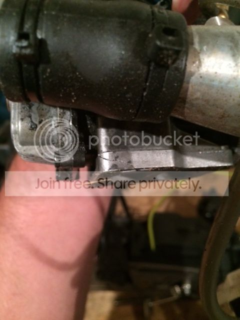

So I started the tear down yesterday and so far all looks pretty good missing a few screws here and there and the motor mount is cracked. I got some pics of it all not done tearing down yet but am working on it.

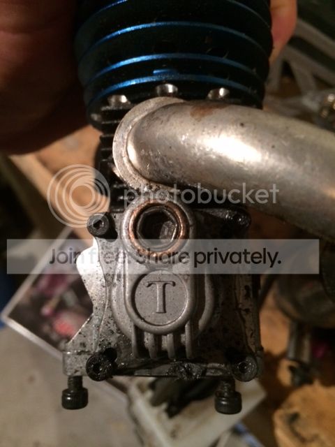

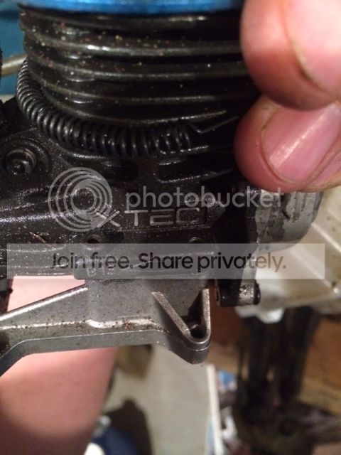

Cracked motor mount got a new one in the parts box
missing motor mount bolt the other three where loose causing the engine to rock in the mount.

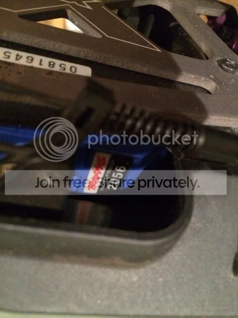

traxxas servo used for the throttle I have a box with servos so I will be replacing once I see what I have may need some opinions.

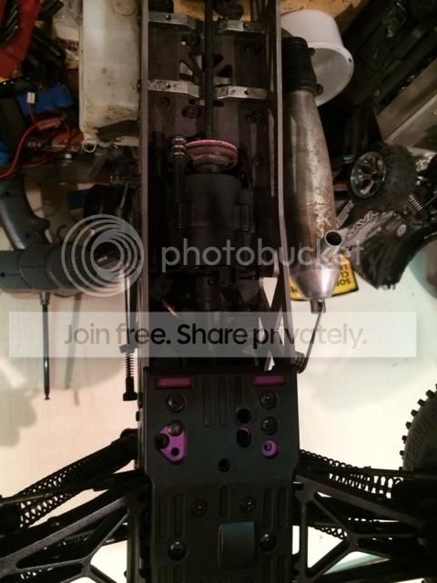

underside of truck looks pretty clean.

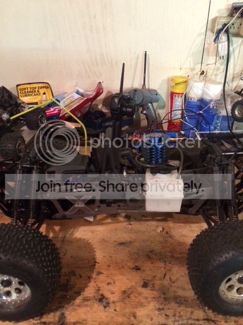

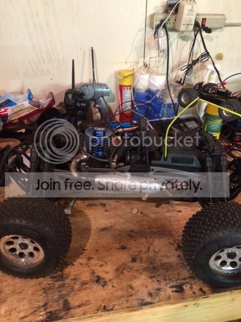

side view all looks good
other side view

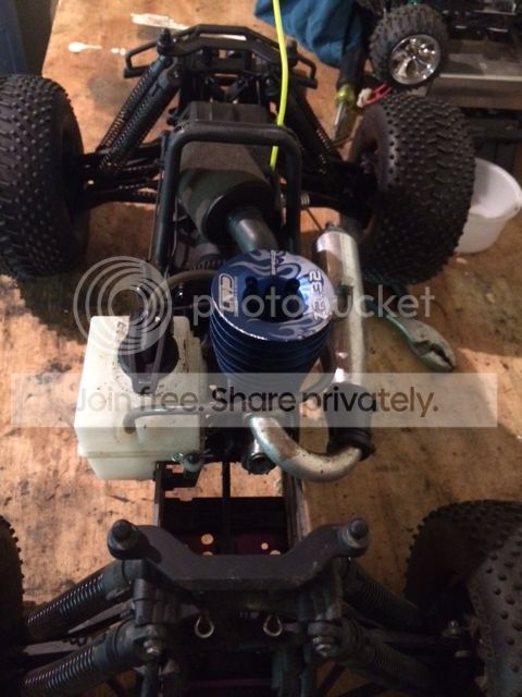

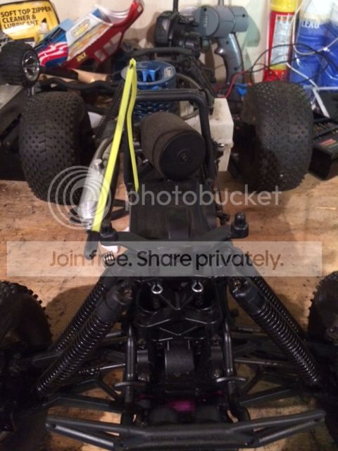

top view
another top view
Overall I am content with the purchase found one broken hex pin and one stripped wheel hub opposite corners. The engine has great compression when turning over by hand I will post pics of anything else I find out of the ordinary.

I think a ritual banishment needs to occur for that traxxas servo. I mean, I actually feel dirty seeing a traxxas part in a savage. Lol:yuck:
Oh it's going LOL I just got to dig through my box of servos to decide what to swap it with

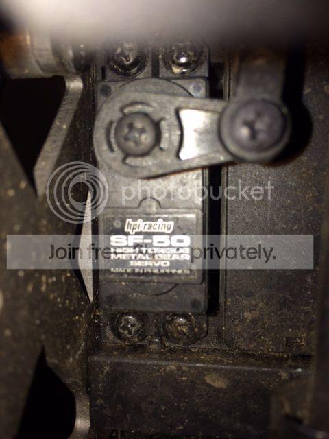

Is the savage SF-50 servo worth putting in place of the throttle servo or should I see what I have before making the swap.

I am using a FlySky GT3B to run my MMT and my Savage with it has tons of adjustability and is comfy in my hand, as for those servos ya have I would use the best one in steering and use the sf50 in throttle location.... I looked on hitec site but did not find those servos you listed, maybe they are old or something.... either way you want something in steering that can do 200 ozin so it will steer tho...... I have had good luck with the servos sold by hobbypartz.com the solar servos are nice and strong and last well in tough conditions and the price is great also.... The are also the seller of the FlySky Radio system I listed above....

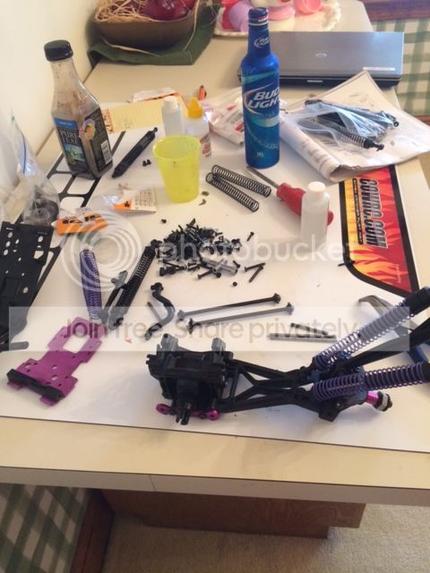

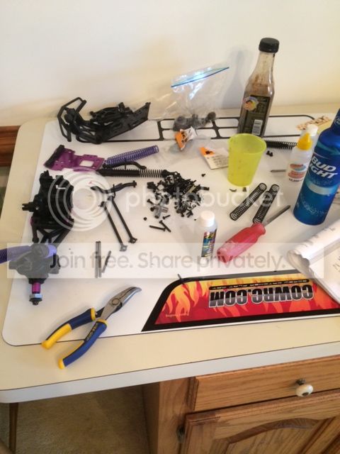

OK here is my update for the week yes at the rate I am going I will be old and retired before I am done with this truck. :) I have received the new Flysky radio and receivers they look nice just haven't tried to bind them yet, I have received the complete screw kit since several of my screws are bent including the shocks. I have the front half tore down and the diff soaking in simple green they diff was full of grease no oil at all. My plan is tomorrow to re-assemble the diff and fill it with 10,000 weight oil and reassemble the front end. I need to order a new roto start as the one that came with it will not spin at all and I have tried several different batteries.
I swear I am still working on it finally had a few minutes again today I have all my parts finally even the starter shafts I am doing my best to have it back together by next weekend we will see. Check out my kicking Mad Cow Mat I love this thing it's great when working in the house and the kids are running around.
