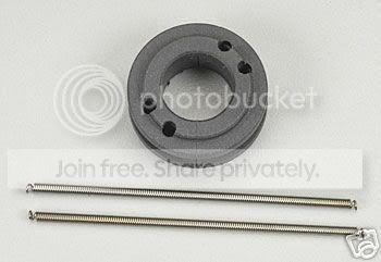

There is a adjustment on the clutch. I pulled the engine and move the clutch to a different position on the flywheel. (see pic) there is 2 holes on the clutch you just move the clutch on the other pin.
So put the engine back in hoping this will help. and....... NOTHING it didn't help at all, I couldn't tell the difference. The engine would rev really really really high and wouldn't pull the truck at all. And still no tranny shift.

Thats weird ACE . what clutch bell did you use ? Iam using a stock hpi 17 tooth. And I noticed the very front of the clutch (that lip you see in the pic) was rubbing on the front of the bell, if I was to drive it much more like that it would wear down quickly and the flywheel pins would start to rub..
