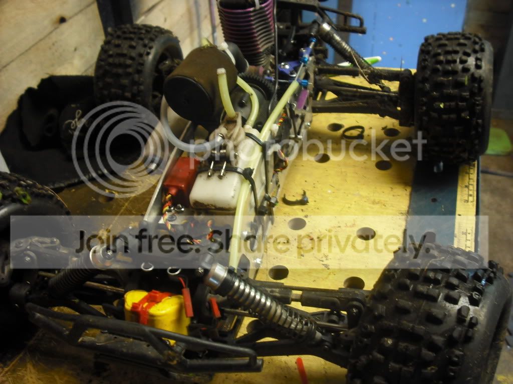

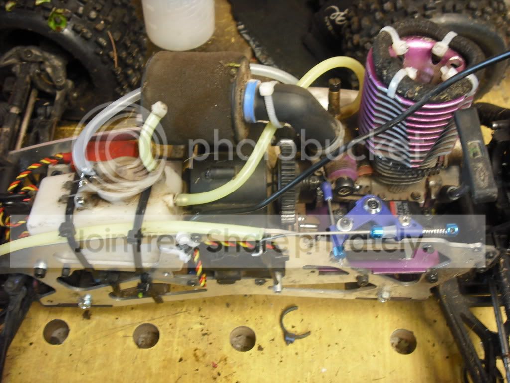

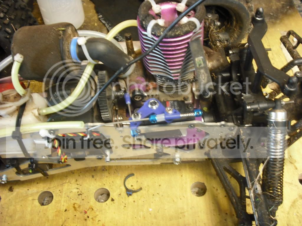

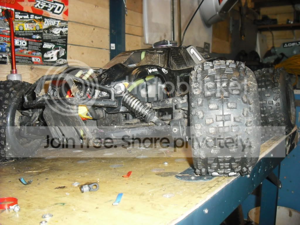

ok so i got tired of my imfamous sideways truck it was too heavy to really do anything with so here we go with a redo. pretty typical truck for me, i made a custom steering servo mount, and mounted the throttle servo to the side of a set of 25 tvp's used a variation of banks better ofna mod ( i love the control this set up gives). and some modded shock towers that are about 3/8ths of an inch taller than the ones i made for the sidewinder. put the trusty old k4.6 in it on 18/47 gearing and have one heck of an awesome handling truck. no rsc either
i still need to make a mount for the tank to make it permanent but the zipties work for now. have to also balloon the reciever . let me know what you think guys. i will get some better pics of the shock towers as they are too easy to lower.
