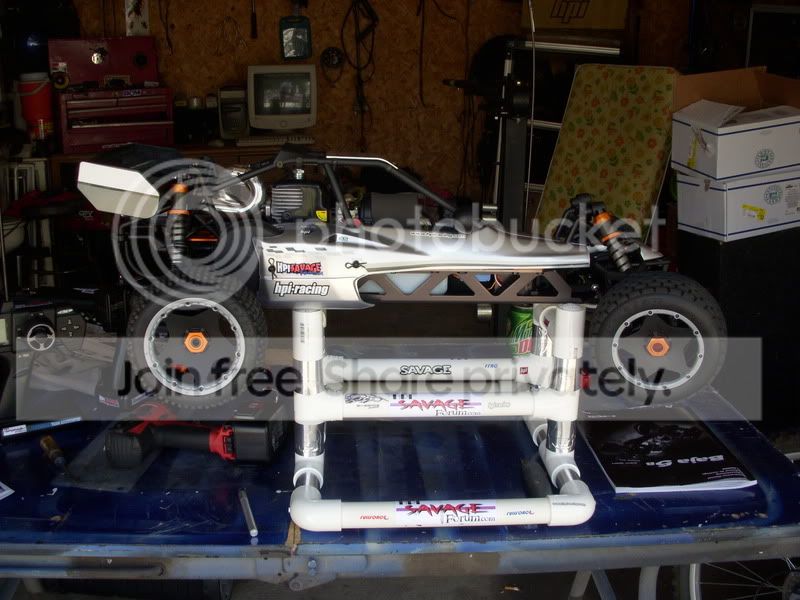

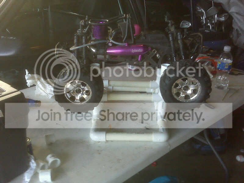

my stand is one the cheapest easiest ones to build its nothing more than 1 inch pvc pipes and elbows and 4 t's it folds to.. easy to carry and transport. ill get dementions if anyones intrested ..

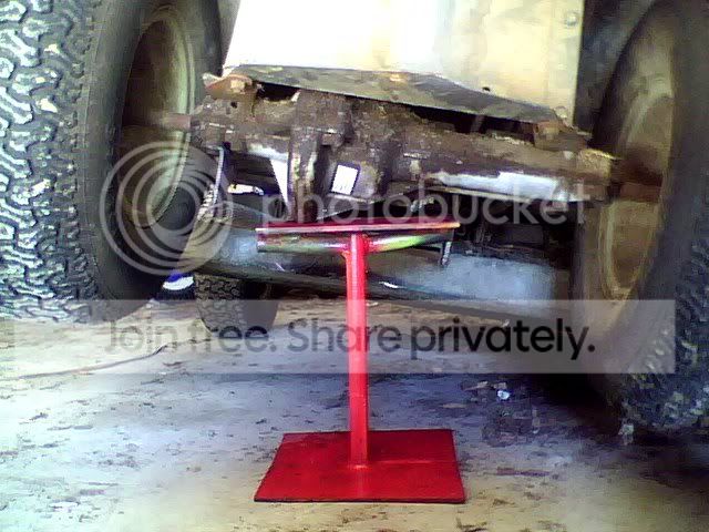

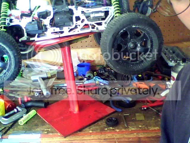

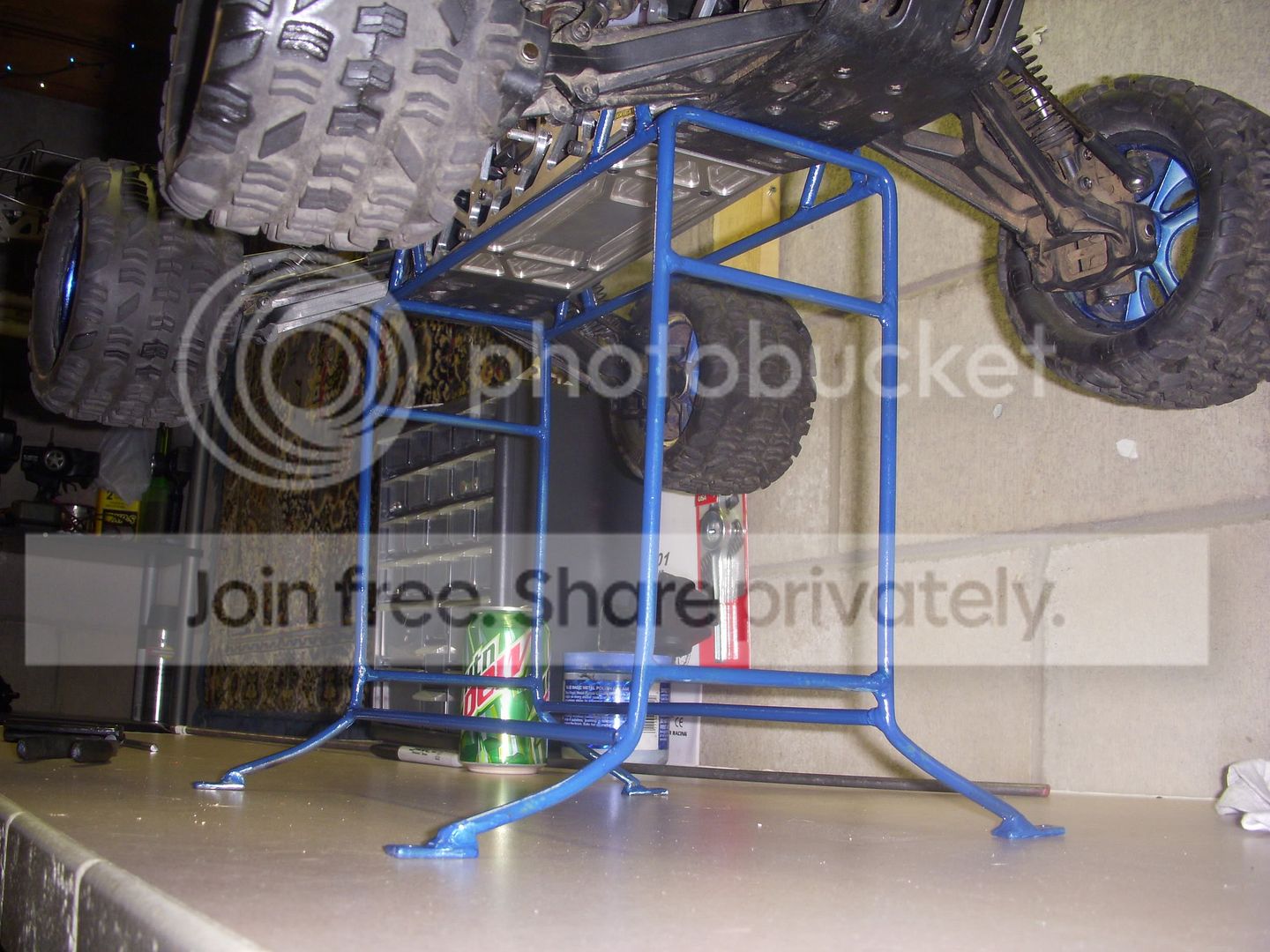

ok here's mine guys plz excuse the mess in the back ground i have a few projects goin on and stuff. mine is made of AR plate and bar stock, the bar stock is 3/4"x16" with 3 plates of 4"x8"x3/8" and all welded up by useing jetrod(7024). and it weighs as much as the savvy.
