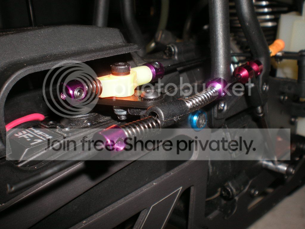

Use a piece of fuel tubing in place of The spring on the linkage for the brakes.
What does the tubing do
Damn man it's just that problem with it not responding how it's supposed to. You think it could be caused by an issue relating to the spur gear/clutch bell since I changed those out for heavy duty ones. I just hoped I didn't burn out the clutch or anything. But thanks man ill be looking into some servosHOBBY SHOP ????? Damn they gonna charge ya a small fortune just to look at it...... are your steering and throttle servos stock? if they are think about upgrading to a couple different ones, a stronger servo will make the throttle and brakes work much better, there are servos on e bay for good prices and if you look at the specs try to find one with at least 150 ozin of torque for throttle and something with 200 or so for steering.....
