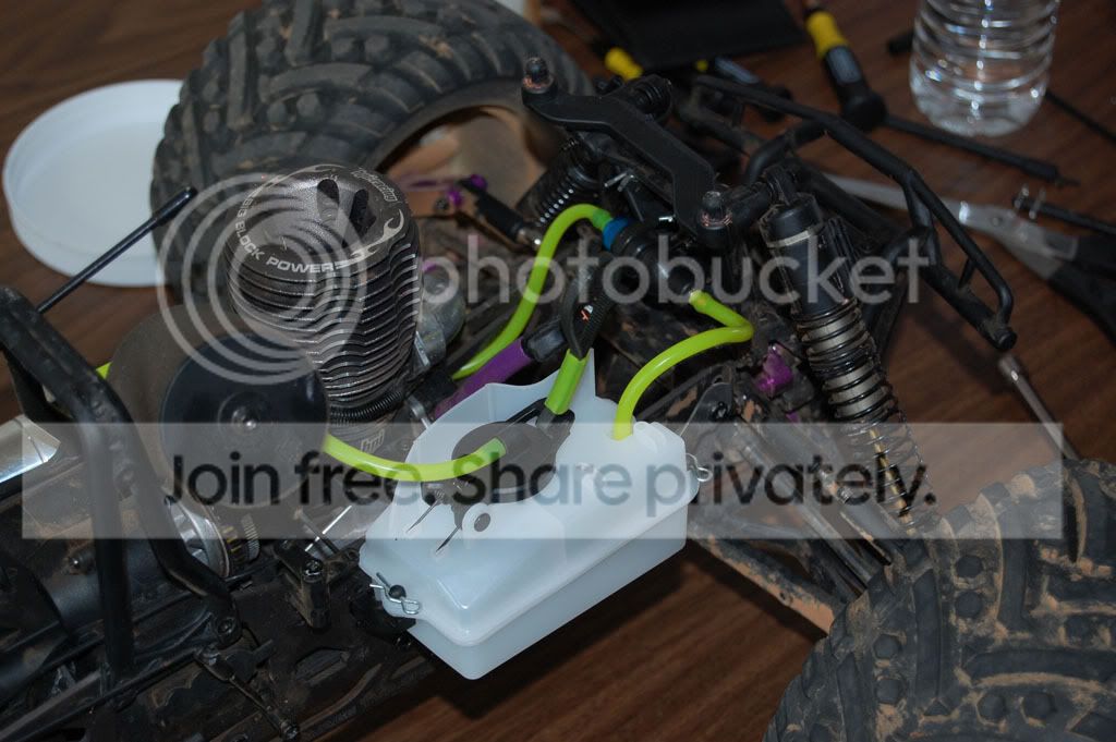

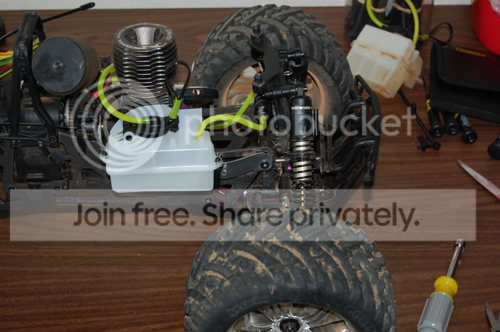

So I was messing around today with my Savvy XL, and my wife’s RS4 Nitro3. I was sitting there looking at the savvy, and the RS4, and it hit me, this little tank it should fit behind the motor. So I hold between the TVP's and it fits. So out comes the zip ties and fuel line......now this is just experimental, I am going to test it out in the back yard, and look around to see what other tank options are out there. Before I start fabbing brackets, and bending sheet metal for a heat shield. So far the only drawbacks to this is, the tank is only 75cc but hey the stock tank leans out about half way through, and 75cc’s is 5cc’s less than half the stock tank. Also it gets in the way of the rotostart so pull starter would have to be used.
So while I am tinkering with the RS4 tank, I though hey, why not convert it into a header tank……. So I put the stock tank back on, ran some fuel line and it should work…..
So what do you guys think?

I just got back from running it with the RS4 tank. It works great, I never fill the stock tank up all the way because of the mid tank lean, so it really wasn't that much difference... but yeah I am going to do some research on other tanks sizes.:jamout:
Tomorrow if I get a chance I am going to try out it as a header tank....:Xfingers:

Basically if i was to mount a tank aft of the motor i would use a larger tank, i am just using the RS4 tank to get an idea of tank size/layout and mounting options... i have a few ideas.......:motorcycle:
um.......... I mean got any full shots to see how the tank and header tank looks from afar?
how's that?

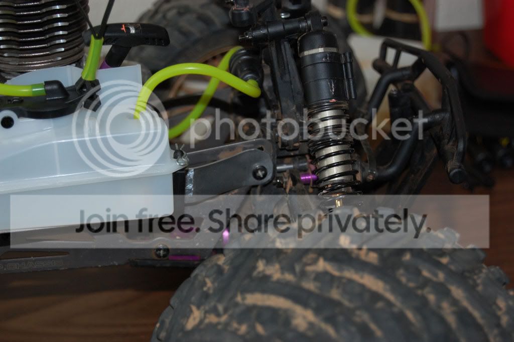

So ive decided to just stick with my dual tanks until I decide witch mid tank mod I want to go with... so far its working pretty well… I was digging through my spare parts and I found some stuff to mount the tank with so no more ghetto zip tie mounting. There were some drive train and tank clearance issues mounting it with zip ties anyway.
I used spare parts from my RS4 Nitro 3….
Two body posts Part#85032
Two binder head screws M3x15mm Part#Z569
Four Body clips Part#6122
One Fuel tank Part#87021
I mounted the body Posts to the rear bulkhead lower plate using holes that are already in the part from the factory, so I didn’t have to drill.
Then so the tank would fit the body post’s I used a body ream to increase the diameter of the mounting holes…
Then put two body clips so the tank would sit at the Height I wanted, put the tank on the body posts then the second set of body clips to secure the tank….
So that’s it what do you guys think?
