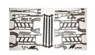

If you know the length of tie-rod you need, check out lunsford. They make many various lengths of titanium turnbuckles and you should be able to find something there that will work for you. I ran those on my losi aftershock back in the day, they were tough as a coffin nail. I kept busting stock tie-rods on the front/turnbuckles on the rear. Never had an issue again after spending the $ on lunsford.
https://lunsfordracing.com/collections/turnbuckles

Yeah, you need the super duty bones for the flux hp/octane, but you will also need the diff cups as well if yours aren't the larger ones.
https://www.hpiracing.com/en/part/86246
quite bad news, thanks :LOL:
I really want the extention cause you will also have a much better look at the steering/caster blocks....
And they are stock so you can imagine the savage drives bad with this setup right now...
So now I need the XL flux bones and the diff cubs will also not fit, really ? o_O to change the cubs you have to open the diffs right ? Can I replace those diff cubs with no more work/exchances of parts ?
But actually I wanted to go for the extended flm arms with the longer dog bones... so I would only need new diff cubs right ? Not sure if the savage still looking good, much wider and lower...

If it was nitro, you could get away with the smaller cups and maybe find extended axles that were standard size cup, can't recall if those exist or not.
These should be a direct fit, and yeah, you have to take the diffs completely apart.
Super Duty Diff cups (need 2 pair):
https://rc4me.us/product/hpisav8020/
Super Duty bones (need 2 pair):
https://rc4me.us/product/hpisav8028/
Super Duty Extended axles (need 2 pair):
https://rc4me.us/product/hpi86249/
