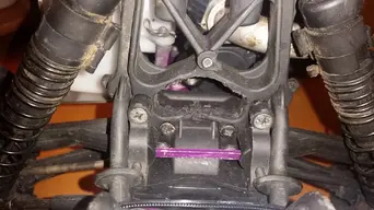

That is the way I like to do things I don't like to redesign I just want a good solid upgrade without a lot of fuss I also have pics of my Savage X where I lightened it up a lot without sacrificing any durability if you want I can post the pics I have in my phone and I have done this eight years ago and still have not broken anything
I used a Dremel in these areas with a carbide tip I actually took out quite a bit of material in these areas and yes it did lighten the vehicle that in 8 years I have not broken anything I do have backups just in case especially in the Roto start area front and rear
Personally, I don't see the point in "lightening" a savage. I mean, I haven't seen anything/anyone posting anywhere about "racing" MT's in the past 5 years and the savage is really just a bashing machine. So, shaving a few ounces off a 15lb+ truck just seems like a waste of time to me.
For my needs, if a mod is not going to make it tougher, then it's not needed. :)
I do it because the friends I race with I always want the best that I can possibly get so I'm always in the lead and I get bored staring at it like I say I'm always tinkering around with things give me something to do
