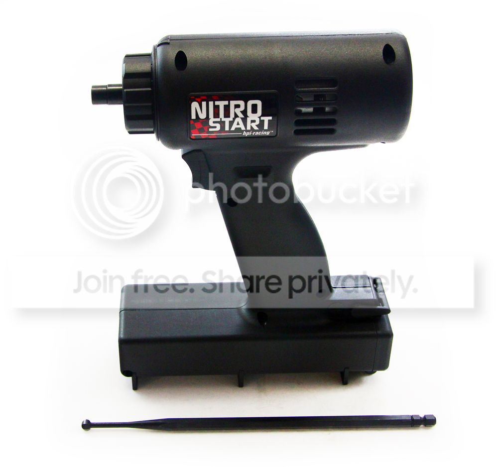

This is nitro start system that comes with the latest savage car.
It's black colored not silver and this is the shaft I mean this is a net pic not mine.

Never seen that system before. It's curious, the new savage still lists the roto-start system.
http://www.hpiracing.com/en/kit/109083
Even the nitro start manual shows a monster king, not a savage. And It does look like it is standard for the monster king truck.
http://www.hpiracing.com/assets/documents/instruction_manuals/i87630_nitro_start_system_glb_m_v1.pdf
http://www.hpiracing.com/en/kit/10861
Anyways, your shaft is this one.
http://www.hpiracing.com/en/part/87617
Yeah I see,
The thing is the nitro start rotor came in the box, not sure why the site still shows the old rotor..
Anyway is there a way to buy it in the HPI site?
