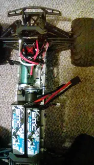

Fast lane machine is where i got a lot of my chassis parts. Went with castle creations esc and motor combo.
I got on Fast Lanes website and its a no go. Thanks for the suggestion though.
They do not have a kit you pick the parts you want like i did. Are you wanting to use battery trays? I did not i put my batteries between my tvps.
what parts did you need. I know I'll need a engine mount but what about the gears?
what size motor did you use? I have a 5700kv castle creation sidwinder 3 I was going to put in it. Thoughts?
That will do very poorly in a Savage. That setup is made for 1/10 scale and can only run 3s.
